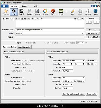

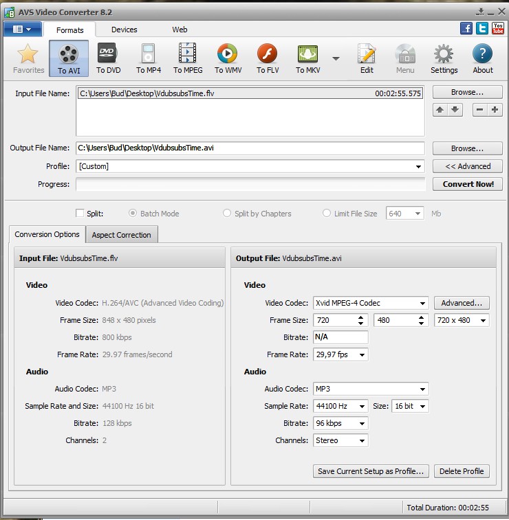

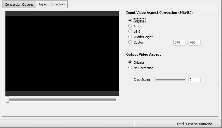

    Just wanted to add to the great replies so far. I like Virtualdub because it seems to vary its sample rate as it converts and makes the ones I convert seem a little better than many other converters. I know most of us here, including myself, like the free software and most are good quality utilities created by talented programmers and developers but... I would like to mention one of my favorites that I use when I need something converted that does not work with the others. I use AVS4YOU video converter because it had a lifetime registration fee that also allows downloading ALL their 18 different products for Audio/video/DVD/document convertion forever. To do what you wish also lets you choose bitrate for most codecs and configure for XVID (if the codec is on your PC). Aspect ration is also included and if you choose edit, you can clean up, sharpen, brighten, etc.
Name:	ScreenHunter_118 Sep. 24 08.22.jpg
Name:	ScreenHunter_119 Sep. 24 08.22.jpg
Name:	ScreenHunter_120 Sep. 24 08.35.jpg
    As you can see this one converter even makes DVD's with menus or converts the IFO from a ripped DVD into video formats.
    Anyway, if all else fails, you may want to check it out. With HD videos I usually just crank up the fully adjustable bit rate if thats an option for the codec I'm using near the original settings shown on left and quality usually remains the same. OH, and if I have a problem, the techs actually answer back (1-2 days ) or even send me corrected file to fix a problem.
    Well thats my pitch for the day. Give the trial version a shot if all else fails.

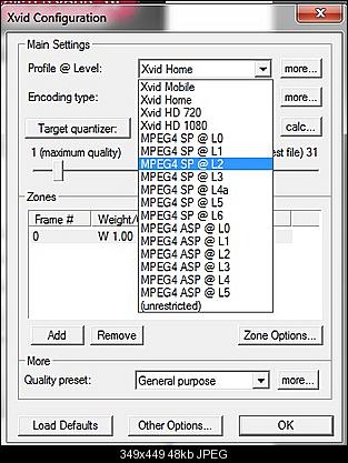

    Ok, im finally found the best settings for source video. Now its converted to 300 mb xvid avi, quality nearly same as source and audio mp3 128kbps. Just last question. Will it make any difference in quality, if i use mpeg4 sp or asp ? I now use xvid home. Which one is the best ? (XVID)
  12. Those presets limit the encoder features to comply with the playback limits of different devices. Use the highest preset you're playback device supports. For PC only playback you can use Unrestricted.

    Well, best way to tell is to encode a very short video and see which you like, looks, size,brightness, etc. according to wiki:
    Simple Profile (SP)
    Simple Profile is mostly aimed for use in situations where low bit rate and low resolution are mandated by other conditions of the applications, like network bandwidth, device size etc. Examples are mobile phones, some low end video conferencing systems, electronic surveillance systems etc.
    [edit] Advanced Simple Profile (ASP)
    Advanced Simple Profile 's notable technical features relative to the Simple Profile, which is roughly similar to H.263, include:Personally, I've never been thrilled with mp4 (ouch... ouch... don't beat me... LOL) that is why I downloaded XVID codec and have been happy with the size and crispness of it. Also XVID used to cause many people problems only because they did not have the codec, but that usually isn't a probelm now with Windows 7. Although, to be honest, I haven't used mpeg4 in a while so not sure if it is better but as it said above, it's roughly H263 and H264 has improved on that.
    Try the short encode method and see which you like and if you go with mpeg4 I'd say use the ASP since it supports Quarter Pixel and GMC. Full descriptiuon can be found here.. http://en.wikipedia.org/wiki/MPEG-4_Part_2
    Budman1
  14. Don't use Quarter Pixel or GMC. You'll regret it if you ever get a standalone media player to hook up to your TV. Or a portable player.

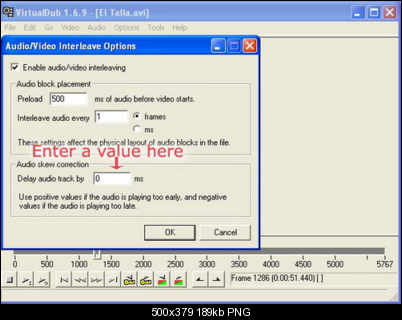

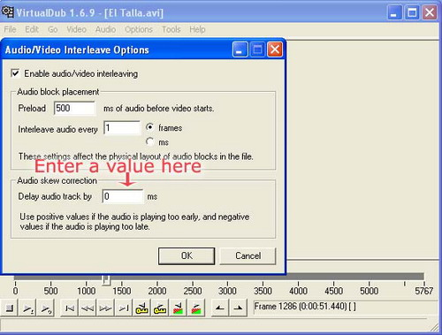

    This fix assumes you have Virtualdub installed and working. It is very handy tool especially if you also have AVISynth and FFMPEG installed. They all work together for many purposes and other utilities. Since Virtualdub saves only as AVI, if you want a format such as FLV, you will have to use one of the MANY converters available. (An alternative is using AVIDEMUX which has variable frame rate to adjust to audio but is more trial and error.)
    I have had the same results before and the sync will be off in one of 2 ways. About the same all throughout the movie or gets progressivly worse (or better) as the video plays along.
    If it is off by the same amount throughout the video, do the following:
    1. Open your video file in VirtualDub by dragging and dropping the file on the program.
    2. Click on Audio -> Interleaving or press (Ctrl + I) on your keyboard.
    3. Now in Audio skew correction text box type a value in millisecond (1000 ms = 1 second) following the instructions: Use positive values if audio is playing too early or negative values if the opposite is true.
    4. Click Ok and don't forget to Click Video -> Direct stream copy and Audio -> Direct stream copy because we do not want re-encoding here.
    5. Click File -> Save as AVI or press F7 on your keyboard and save the file.

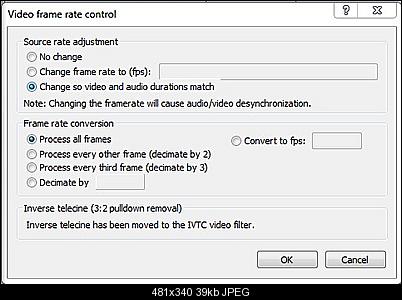

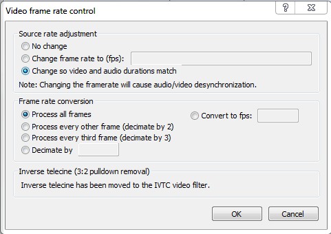

    If it is progressive (gets worse) as the video goes along, do the following:
    1. Use FLVextract for FLV videos only of course) to extract separate audio and video. You will probably notice that the time length
    is now different for audio and video.
    2. Run virtualdub and drag and drop the extracted video onto Virtualdub.
    3. Select the audio tab and choose 'audio from other file..' and find the audio you extracted and select it.
    4. Select direct stream copy for video since it should already be compressed when you extracted, or I chose the codec
    I preferred and it still worked. Do the same for audio.
    5. Select the video tab and click frame rate and click 'Change so video and audio durations match'
Name:	ScreenHunter_133 Sep. 28 13.05.jpg
    Save as AVI.
