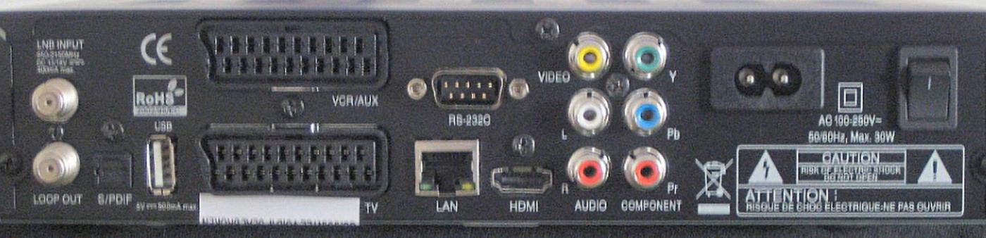

    every thing on my box is. white yellow red. . green blue red.. 1 rs232> 1 usb >2 scart> 1 hdmi .. i will try some time today to upload a a 5min. video then i will post the link on here thanks
  9. Member DB83's Avatar
    Jul 2007
    I did ask you to check your manula for the conection and not use your eyes for the connections.
    But if you have 6 rca then they should be component. Is one of these 'reds' more 'pink' ?

    both reds look the same to me... so what leads and device would i need to record in hd. in your opition
  11. Member DB83's Avatar
    Jul 2007
    The botton line, if you are reluctant to read the manual which will confirm if it is component or not, id that you can not record in HD if you have one hdmi and that is already in use.
    You can record as analogue using the RCA, whatever it is, or the scart using a scart to RCA adapter to connect to a capture device.
    Is it too hard to read the manual?. I assume you have one. I found one on-line but it may be a different model - as that did not mention scart - to the one you have. Maybe you can give me the EXACT model.

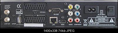

  13. This device? http://www.youtube.com/watch?v=C4_Ni-uZt8E
    The yellow composite video output will only give you standard definition. The component outputs (Y, Pb, Pr) can give you high definition video but many devices will not output both HDMI and component at the same time. You should check that before committing to an expensive capture card.
    The HDMI output is almost certainly protected with HDCP. None of the mentioned devices will record HDCP protected HDMI. If you want to record that you will need an HDCP stripper -- which may be hard to find and illegal in your country. You'll also need an HDMI splitter so you can send one signal to the TV, the other to the capture device.
