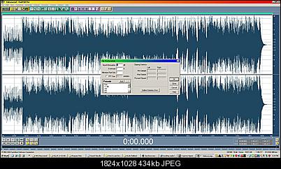

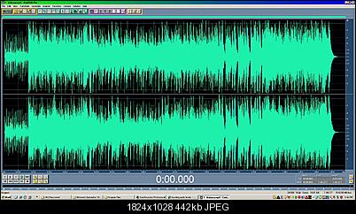

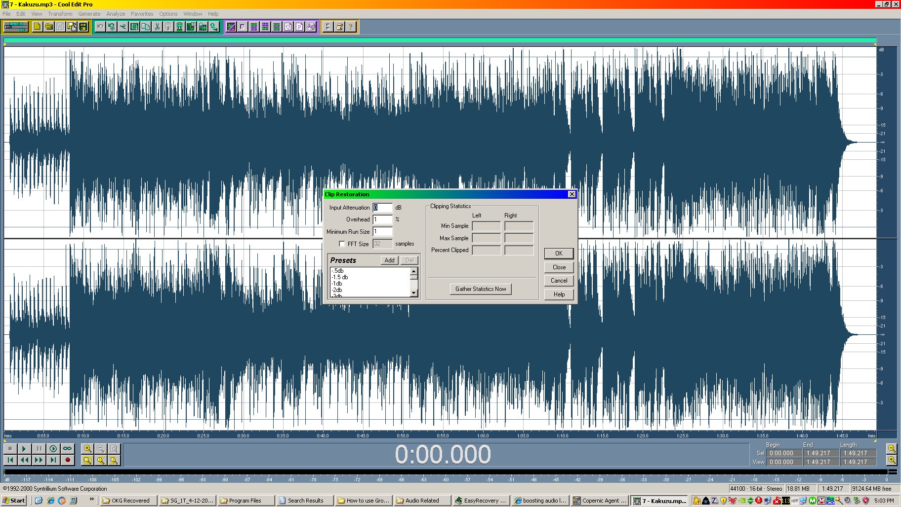

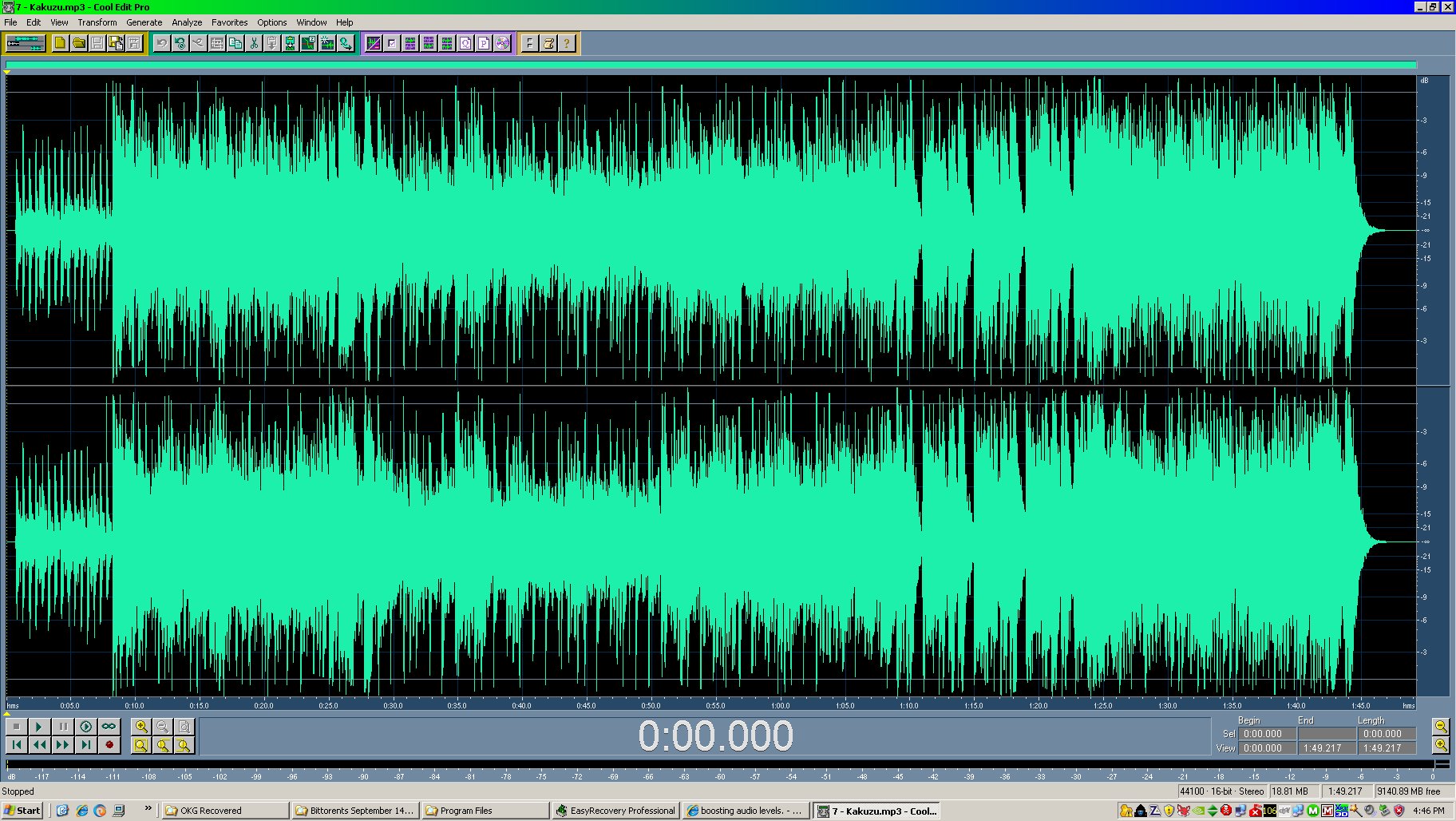

    I opened up your mp3 file in Cool Edit Pro 1.2a ... actually it looks very decent ... nice dynamic range ... I'd for my purposes would probably use CEP 1.2a to keep the peaks within the main window and not be poking into the forbidden zone
Name:	7 - Kakuzu - CEP 1.2a.jpg

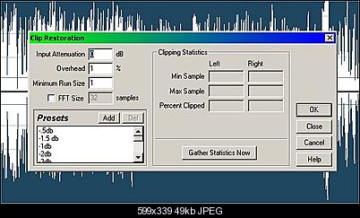

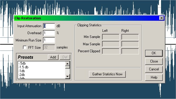

    I have created my own settings for reducing peaks that are clipping outside the window
Name:	7 - Kakuzu - CEP 1.2a - Clip Restoration - Smaller.jpg
ID:	13993Click image for larger version
Name:	7 - Kakuzu - CEP 1.2a - Clip Restoration.jpg
