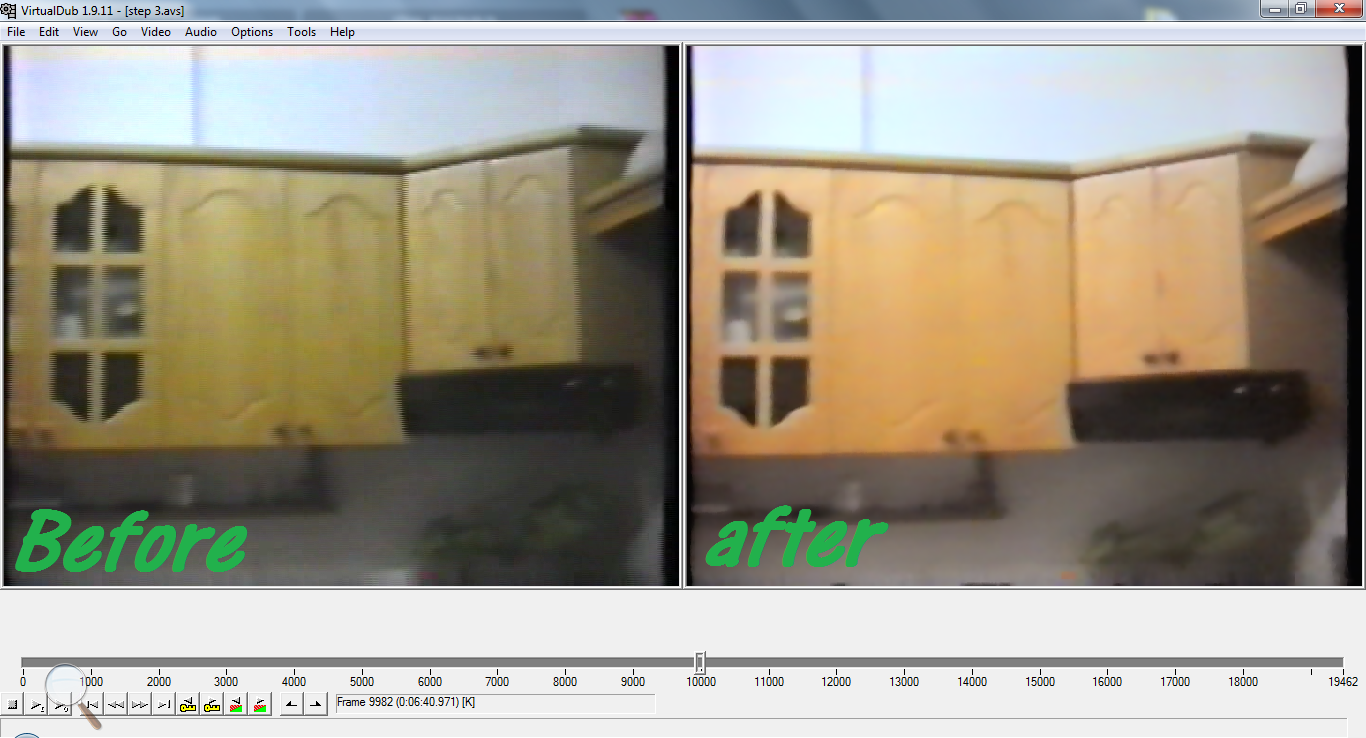

  10. I want people think I filmed all this yesterday
    Pros and serious hobbyists split videos into many scene-by-scene correction projects. I think that would be demanding for you at this point, and most people wouldn't go that far.
    I will certainly do so. I've been doing it originally. But for the colors I'll have to cut into smaller pieces of video. It was not the original plan ..

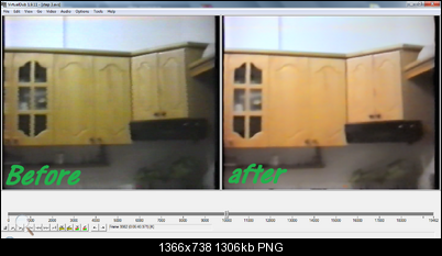

  11. Banned
    New York, US
    Old tape has many problems. One of them is uneven fading of color information (reds might fade faster than blue or green), or uneven color stains and blotches along edges or borders. Sometimes you might notice that most viewers focus on the people in family videos; they don't even notice the furniture, and they seldom recall or even notice colors. In the image of the kitchen you posted earlier, I noticed a portion of a wall below the cabinets and an area of white above them. If that wall and upper area are shades of whites and grays, they are guides to the overall color balance. Grays and whites should have equal portions (or approximately equal) of Red, Green, and Blue., whether they are light or dark in intyenbsity.
    In the images you posted, the "before" picture looks more accurate to me than the "after". The left-hand cabinets are closer to yellow than are the right-hand (after) cabinets; the left cabinets look closer to orange than to yellow. I notice that the cabinet on the right-hand side of both images has a dark fixture along its bottom border. In the "before" image that object is nearly a black color, and below it and in the right corner there is something green (a plant?). In the "after" image, the black object and cabinet knobs are closer to dark brown; the plant is losing its green color (well, I think that's a plant ? ?). Also, look at the bright, upper portion in both images. They look stained (magenta or pink areas, sometimes uneven blue).
    If you use a pixel reader, you can see these color values. The cabinets in the left image have average pixel values of R175 G165 B95. The cabinets in the right ("after") image in the brighter areas have average pixel values of R235 G190 B120. Those numbers tell me that Red has been added to the original, and the later images are brighter overall. If you know basic color theory, you would know that Yellow is a "secondary" color, so called because it is made by mixing two primary colors (Red + Green). A perfect yellow would have RGB values such as R200 G200 B0. But there are few "pure" colors in nature, not even in a blue sky. So when you say the cabinets in real life are "yellow", a colorist would ask "what shade of yellow?" and "what kind of lighting is in the room?" To me, the cabinets seem to have some wood grain rather than paint, so I would say the color you're looking for is somewhere between the greener left-hand image and the more red right-hand image.
    Brightening midtones in the left-hand image makes a difference in how you see some of the colors. Also, in both images there is too much bright blue, but there is less blue in the midtones and darks. That isn't unusual, especially for old tape with uneven color. A filter like ColorMill lets you correct colors and levels in 3 ranges, so you cold lower bright blue with very little effect on the lower blue. If the walls in the lower part of the image are supposed to be shades of white or light gray (the shadowed areas will be shades of gray, not bright white), then I would read some pixels to see if there is a major RGB imbalance in those areas. (Pixel readers read pixels in groups of 3, so you see the average of a group of pixels, not just a single pixel. It is impossible for every pixel in an area to have exactly the same RGB value). Keep your eye on other objects as well; I see objects of various colors inside the cabinets, and those can act as guides as well.
    In any case, the colors in the right-hand "after" image look closer to what I think you want. The images do look "stained" in certain areas, so don't expect perfection.

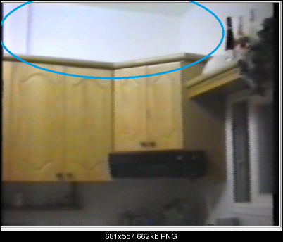

    I found a proof and a sign that justifies the action did - adding red.
    Take a look:

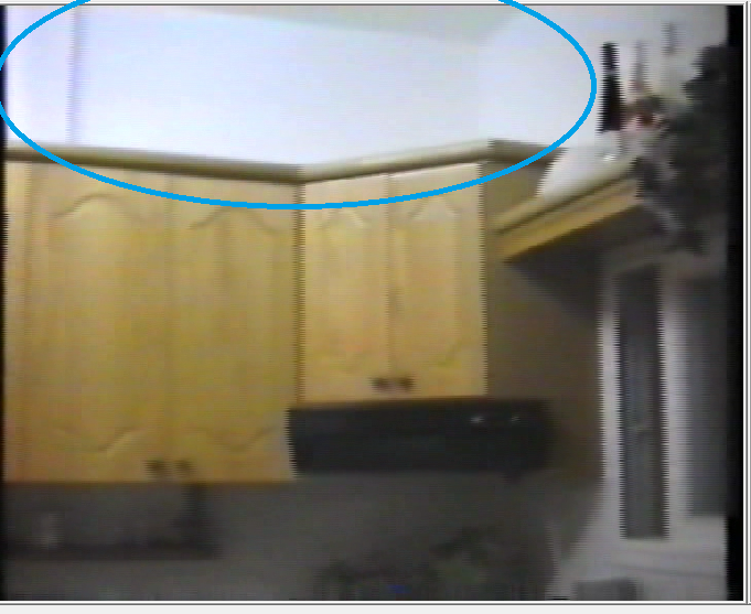

    Where did circle, you can clearly see that there is a surplus of blue.
    This blue color is not natural of course. And the opposite color to blue is red.
    So I guess I made a logical action (add red) ..
    I never thought of this mark before. I relied on memory ...
    What do you think?
    Maybe I was wrong that I added too much red.
    But in that case is there a way to know how many red added by this sign?

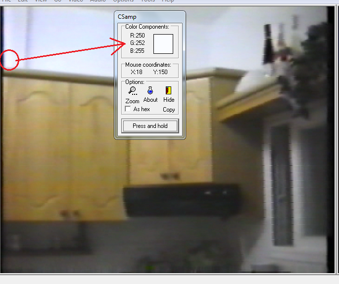

  13. Okay.
    An update ..
    Look what I did.
    The basic assumption is that the color blue over the coffin is not natural.
    So I thought the blue color disrupts the color of the cabinets.
    So what I did was I calculated the color is supposed to be ..
    And I did it this way -

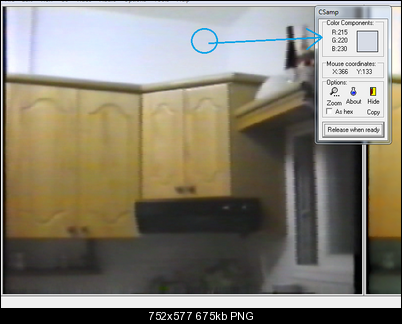

    I took the unnatural blue color:
    and i got:
    R=215
    G=220
    B=230

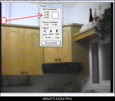

    Then I took the color should be (not blue) from this point:
    I got:
    R = 255
    G = 255
    B = 255

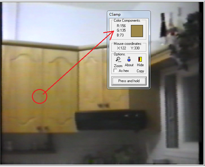

    Based on this, I knew that in order to fix the blue part I should add for R - 40 (255-215), for G - 35 (255-220) and for B - 25 (255-230)

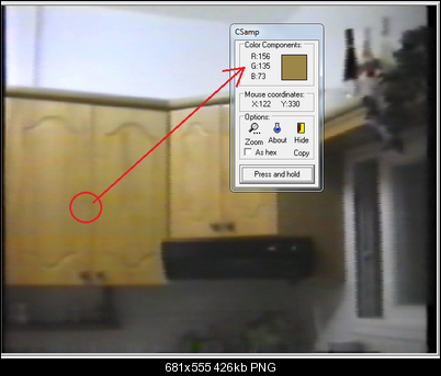

    so the color from the Cabinets is:
    R = 155
    G = 135
    B = 75

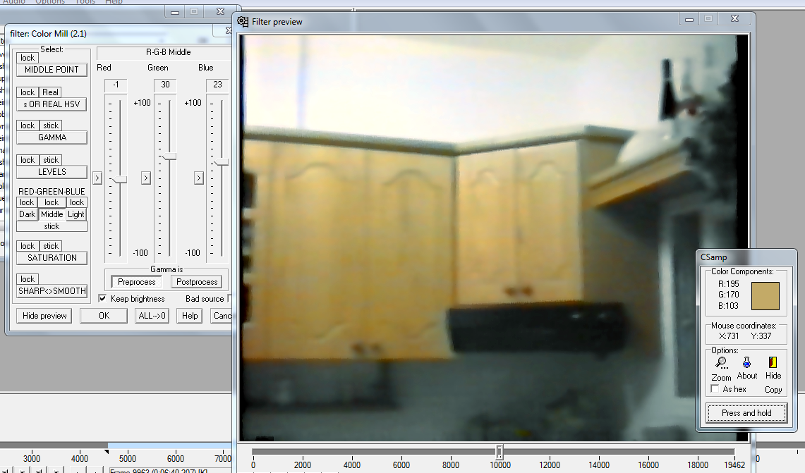

    So to correct the color I need to add for R - 40 , for G - 35 and for B - 25

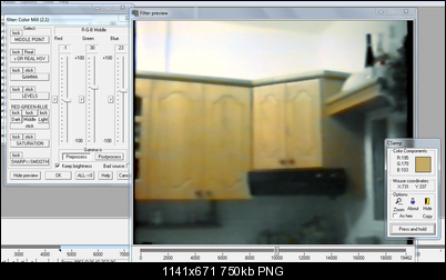

    The result:
    R = 195
    G = 175
    B = 100
    The final result:
    Is that correct?
  14. I suspect that blue tinge is only at the top of the frame.
  15. Banned
    New York, US
    I think jagabo is correct. Judging from your earlier videos, the tape has visible rainbows and stain across the top of the images. It's easier to see against bright colors such as white. It's not possible to fully correct uneven discolorations such as those, although correcting for overall color balance and smoothing-out "peaks" in certain color ranges can sometimes make rainbows and stains less visible -- as you can see in the above images. There are also some Avisynth plugins that can mitigate the problem.
    The video has other color problems that Avisynth techniques might help. For example, look at the cabinet doors in post #43, bottom photo. In one of the tall doors near the image center, in that door's lower right corner, there is a blotch of excess blue. I saw these discolorations appear and disappear at random times throughout the video. This is usually caused by storing tape is overly warm or humid conditions, but many other causes have been cited. The blue patches are tape damage. Much of the time, these discolorations pass so quickly at the playing speed that often they are not noticed.
  16. The discolored top of the frame could be fixed differently than the rest of the frame by creating two filtered streams and blending them with an alpha mask.

    Just yesterday I tried your instructions seriously for the first time and I succeeded create the example1.avi just like you did.
    And I was very surprised at the difference between the result without your orders, and the result with your instructions.
    I'm not even dreamed of such a result ..
    So thank you very much!
