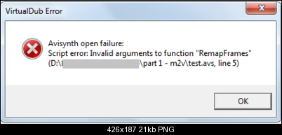

    I do not work with avi files (I work with m2v files) so I did this:
    BaseVid=Mpeg2Source("part 1.d2v")
    SourceVid=Mpeg2Source("part 1 v2(r1).d2v")
    But it did not work .. I got this message:
    What to do?

    If you're using Avisynth, you're working in AVI. MPEG2Source converts to uncompressed AVI. Opening the script in VirtualDub converts it to RGB AVI. You can tell VirtualDub to return the results in another format or colorspace, which is what I presume you've been doing.
    In the avs script, after the last line of your processing you can use this statement:
    return last
    Look at the "return" statement in the sample I posted. It tells Avisynth what to return as the result. In the sample script you posted, the name of the "result" in your last statement is "SourceVid". If that's what you want as a result, the statement could be "return SourceVid". This assumes that your script didn't do any more processing than the lines shown in your script. In the script you posted, all the script does is open a .d2v project and serve the frames to VirtualDub as AVI. That's the only work that the script performs.

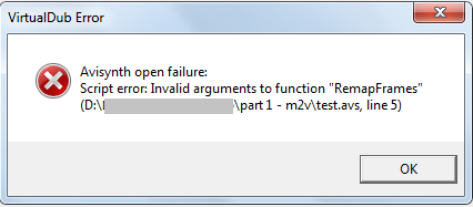

  15. I converted m2v files to avi files and I still get this message:
    https://forum.videohelp.com/attachment.php?attachmentid=14028&d=1348665129
    I converted without compression ..
    This is the test code:
    BaseVid=AviSource("part 1.avi")
    SourceVid=AviSource("part 1 v2(r1).avi")
    What to do?

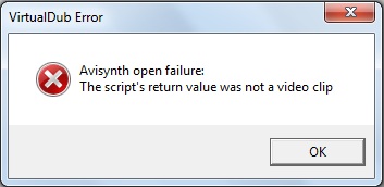

  16. Do something with SourceVid and/or BaseVid. AviSynth returns the video called "last". Whenever you perform a filter it uses the video called last and outputs the video called last -- unless you tell it to use a different video. For example:
    AviSource("filename.avi")
    Greyscale()
    implies:
    last = AviSource("filename.avi")
    last = Greyscale(last)
    return(last)
    In your script you've defined two video streams but not what to do with them or what to output.

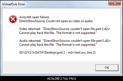

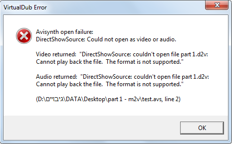

    When you say "I converted m2v to avi files", how did you do that? If you simply opened the m2v's directly in VirtualDub and saved as avi, it will work but that's not the best way to do it, and you could make a mess of the color space if not done correctly. Anyway, you don't have to convert them to avi separately. The DirectShowSource statement that opens the d2v project files creates video streams for VirtualDub that are avi's (effectively). There's no need to perform that extra conversion to AVI containers.
    mapfile="drive:\path to file\mapfile.txt"
    BaseVid=DirectShowSource("drive:\path to file\BaseVideo.d2v")

    Ok thanks for the code ..
    I did this with d2v file and got this error:
    What should I do?
    This is my code:
    HTML Code:
    mapfile="mapfile.txt"
    BaseVid=DirectShowSource("part 1.d2v")
    SourceVid=DirectShowSource("part 1 v2(r1).d2v")
    out1=RemapFrames(BaseVid, mapfile, SourceVid)
    return out1
  19. D2V files are opened with MPEG2Source(), not DirectShowSource()
  20. Originally Posted by jagabo View Post
    Ok .. I just did by example I got here.
    But I thought about what you own and tried this:
    HTML Code:
    return out1
    And I get this error:

    1)
    out1 = RemapFrames (SourceVid, mapfile, "", BaseVid)
    2)
    out1 = ReplaceFramesSimple (BaseVid, SourceVid, mapfile)
    I did a test - I wrote in the mapfile file this:
    [0 9] [100 109]
    10 5
    [20 30] 6
    Then I saw that it works ..
    But I can not get the numbers ..
    In my case Frame 341 = Frame 154 in the second capture.
    So I wrote this:
    [341 342] [154 155]
    But when I run the script so it does not replace the frame 341 to frame 154 in the second capture. It replaces frame 342 to another that i do not know where it came from ...
  23. Banned
    New York, US
    Good work, gil900 You were almost there. But I had problems as well, and I tried the same changes. This is very very VERY strange. I used RemapFrames() in the past, and I use ReplaceFramesSimple all the time. But now RemapFrames() is giving me errors, as well. I resurrected some 2-year-old scripts, and they would not run. After searching for 2 hours in doom9 I see that RemapFrames() had some parsing problems. But I saw no repairs. Finally, through Google Translate I find myselkf in an Indian movie forum where this problem was discussed. Apparently some parts of the RemapFrames plugins haven't been updated for the latest versions of Avisynth.
    Unfortunately I fell asleep for 15 minutes at the computer. When I woke, I had lost all my browser windows! But I managed to copy a couple of solution scripts. Cancel the "mapfile" and the text file; apparently RemapFrames isn't updated for newer versions of Avisynth, so it's not reading outside text properly. I inserted some extra test frames below, so change the frame numbers you will need.
    BaseClip=Mpeg2Source("part 1.d2v")
    BaseClip=BaseClip.RemapFrames(mappings="341 154
     342 155
     200 201
     [202 210] 211
     220 225", SourceClip=Mpeg2Source("part 1 v2(r1).d2v"))
    return BaseClip
    Yes, some of it does look odd. Observe the quotation marks and commas carefully.
  24. Originally Posted by sanlyn View Post
     342 155
     200 201
     [202 210] 211
    return BaseClip
    Thank you!
    Now it worked perfectly
    I'll write a script that calculates the differences between the frames and then everything will be done through pushing a button. I do everything automatically with programming.
    It made perfect patch! Much better than ReplaceFramesMC
