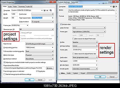

  9. Set your project settings to 1280x720, 25fps, square pixel, field order progressive
    Same with your render settings 1280x720, 25fps, square pixel, progressive
    The reason why you're getting poor results, is you're resampling the framerate from 25 to 29.97, causing blended (blurry) frames, and inserting them at non evenly spaced intervals, so it's choppy
  10. Originally Posted by poisondeathray View Post
    Is this good ?
  11. looks ok
    field order should say progressive in the project settings (it's blank in yours for some reason)
    you can change render settings profile:high , entropy coding: cabac , for better compression
  12. Here is the final video, what do you think about the picture quality ?

    The only problem is- screen on Israel uses 25\30fps, so 29.97 will still make some problems no ?
  30. Originally Posted by Transporter View Post
    According to the MediaInfo report you posted the original video is 29.97 fps:
    https://forum.videohelp.com/threads/349338-Sony-Vegas-10-What-is-the-best-quality-forma...=1#post2188739
    In any case, converting 30 fps to 29.97 fps is much less jerky (discarding 1 frame out of every 1001, 1 jerk every 33 seconds) than converting 30 fps to 25 fps (discarding 1 frame out of every 6, 5 jerks per second).
    Whether your result is "good enough" is up to you.
