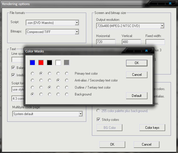

    Are you sure you didn't mess with the colors under Rendering->Color Rendering->Color Keys? Judging from your BMPs, it sure looks like it to me.
    Yes im sure, this is how it looks, check the attached file.

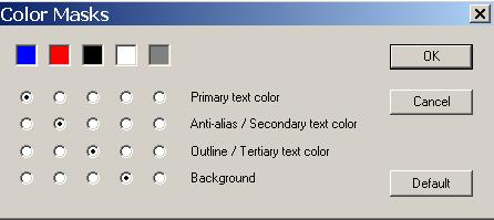

  16. Interesting, mine looks different when I open it up (which is the default setting, I think).
    I have a suspicion that Muxman is expecting mine because I never have the trouble you did, but I'm not at all sure about that. This is with 'Only one set of text, antialias, and outline colors' ticked. What happens when you hit that 'Default' button? Anything? It takes a while until you get the hang of it.

    Oddly anough, even that i havent touched the settings, when i hit the "Default" button, it jumped to the settings you have...
