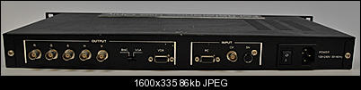

    Sorry, I forgot the essential thing while typing that post . The TBC is a Kramer VP-721DS Digital Video Scaler (a video scaler does the same thing as a tbc right?). Here is a picture of the back:
Name:	Kramer VP-721DS Digital Video Scaler back.JPG
    Wrong. (AFAIK)
    I had a quick read of the manual. It looks to me like a video signal converter - take e.g a 800*600 signal and up-covert that.
    There does not appear to be anything in this unit which has time-base correction (correct unsteady composite/s-video signals)
    There are plenty of topics on here about Pannys and their built-in TBC features. No reason to repeat all that here.
    Finally, the unit you were after appears to be discontinued. How much was the sale price? A proper TBC would cost $200-$500.

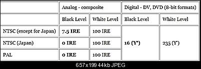

    Furthermore, there's one thing that I'm really concerned with. It is with regards to Japan's VHS black levels:
Name:	Japan black levels.jpg
    Because of these properties (reference black level in Japan is lower than in North America), the video will look darker in any American VCRs. My next question would be: Is it necessary to buy a proc amp to correct this? Or is there a way that I can indicate VirtualDub that the upcoming signal is NTSC-J and then they can revert the black levels back to its intended state (I really hope so)?
    Thanks in advance guys

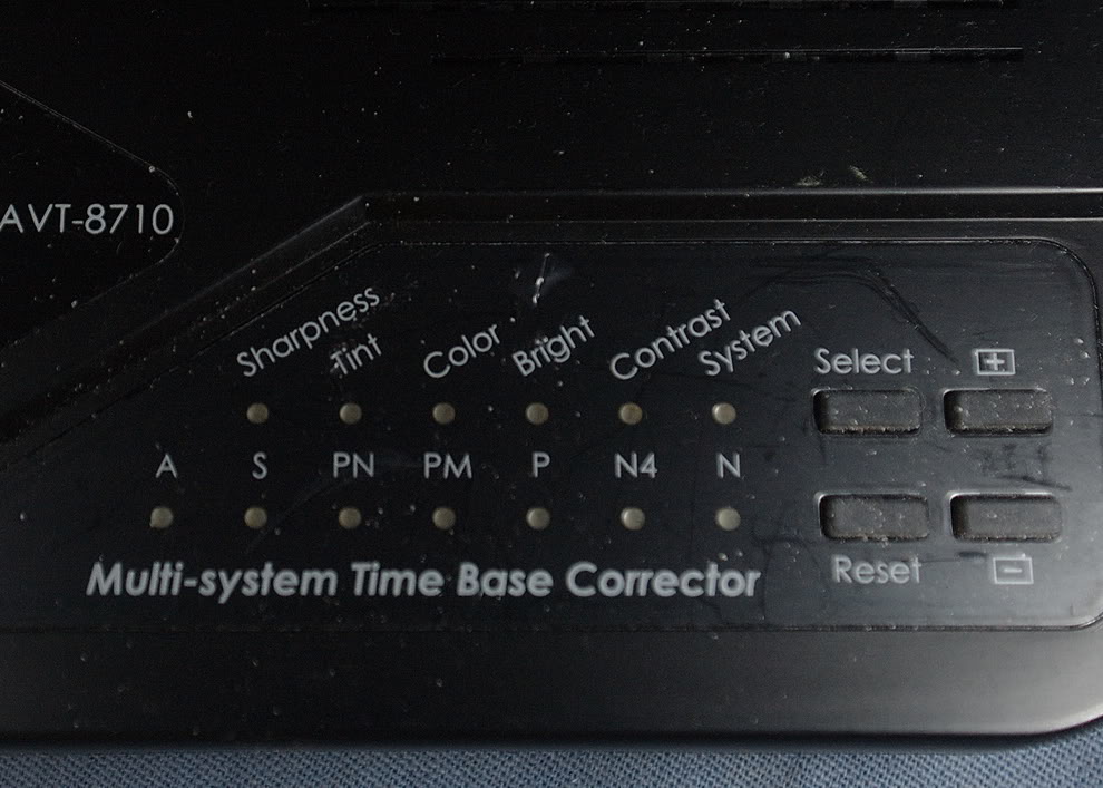

    In case I adjust black levels in the analog realm:
    1- From the stuff I've been reading, I would need to increase the brightness in the TBC to fix the black level issue. Is it true (just to be sure xD)?
    2- Would the AVT-8710 Time Base Corrector be helpful for this kind of job?
    3- Knowing the difference in black levels between NTSC-M and NTSC-J, could you please give me an approximate of by how much would I need to increase the brightness?

    Although black-level is descibed as 'brightness' a simple correction to brightness will not correct black-level.
    I found an interesting write up about the neccessary adjustments here:
    http://www.glennchan.info/articles/technical/setup/75IREsetup.html
    If an AVT-8710 has these controls then it can do the job.

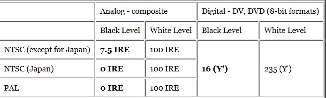

    That article is somewhat confusing to me, but I think I'm on the right track xD. First of all, I'll copy the part from the article that applies to my case:
    A proc amp is typically a hardware device that adjusts analog levels. One of these can be used to convert black level from 0 IRE to 7.5 IRE. You will need to adjust the video levels as follows:
    • Adjust luma gain by 92.5 / 100. This is to compensate for the next step.
    • Adjust pedestal / luma offset by +7.5. Luma black level will now be at 7.5 IRE, and white level at 100 IRE.
    • Adjust chroma gain by 92.5 / 100. To maintain constant saturation, it is necessary to match the chroma gain to luma gain.

    Finally, I looked for pictures of the AVT-8710 TBC and I saw that it has the option to configure those paramaters:
    [Attachment 13968 - Click to enlarge]
    Could you guys tell me if I made the right conclusions (I hope so xD)?
    Thanks in advance.
