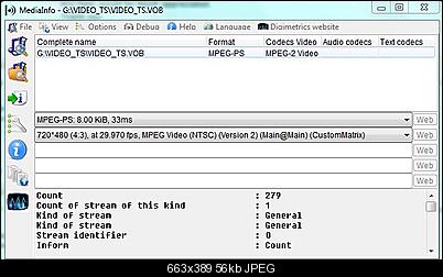

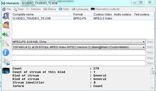

    Is this enough detail?
    Thanks.

    Can you see the screen capture for MediaInfo in my previous post?

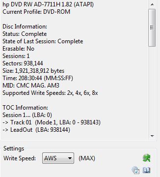

  12. The M.I.D. is the media code that tells you who exactly made the disc. ImgBurn can tell you via Mode-> Discovery.
    Betcha it's CMC_MAG. (CMC Magnetics in Taiwan). Philips has sold a lot of them under their brand.

    Sep 2012
    Ontario, Canada
    Thank you, Frizi93, you were right.
    See attachment.
