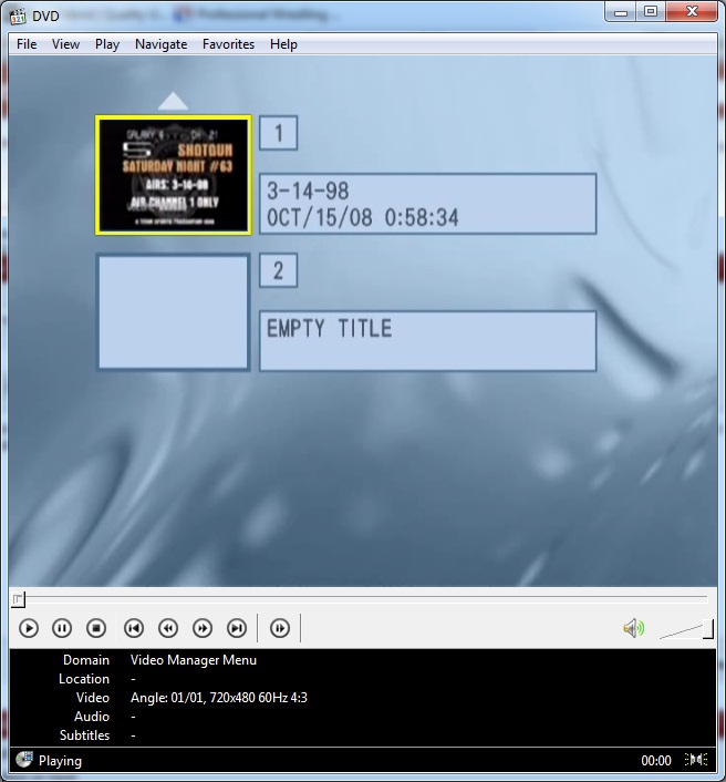

  1. Okay, so I have some discs recorded onto a Funai recorder, but the title (only one on the disc) takes up double the space it would normally. Here's some screen captures to demonstrate. My ideal plan is to reauthor these to two different titles on one disc (other discs are recorded in the same way) but at this time, it won't be possible without compression.
    DVD Menu 1 - http://puu.sh/15q7h
    DVD Menu 2 - http://puu.sh/15q7z (Two titles?)
    DVD Shrink 1 - http://puu.sh/15q86 (Titles 1,3?)
    DVD Shrink 2 - http://puu.sh/15q8w (1 and 3 again)
    Windows Explorer 1 - http://puu.sh/15qad
    Windows Explorer 2 - http://puu.sh/15qaE
    Windows Explorer 3 - http://puu.sh/15qaX (Video_RM directory)
    Windows Explorer 4 - http://puu.sh/15qco (Video_TS directory)

    Well according to one of your screen grabs you have two 4gig movies on one (assumedly) 4 gig dvd. That is not possible.
    But I think the answer lies in the fact that you have recorded using VR mode (the clue is in the _RM folder) which is fooling dvdshrink in to thinking there are two movies on the disk. If indeed there are two movies on that disk and of equal running time then their size is being mis-informed by the program.
