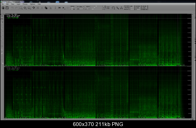

  8. aBigMeanie aedipuss's Avatar
    Oct 2005
    666th portal
    not sure you are using the right term. spectral analysis is for waveforms. as in audio like sony's spectralayers.

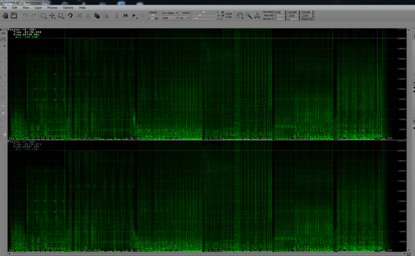

  15. Member budwzr's Avatar
    Apr 2007
    City Of Angels
    No, Spectral Layers is a new "Sony" way of visualizing and editing audio. Sony's DAW sucks, so they're trying something else, and pretending it's a whole new earth-shaking product.
    Myself, I use Ableton and nothing beats it. I've tried them all.
