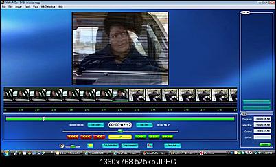

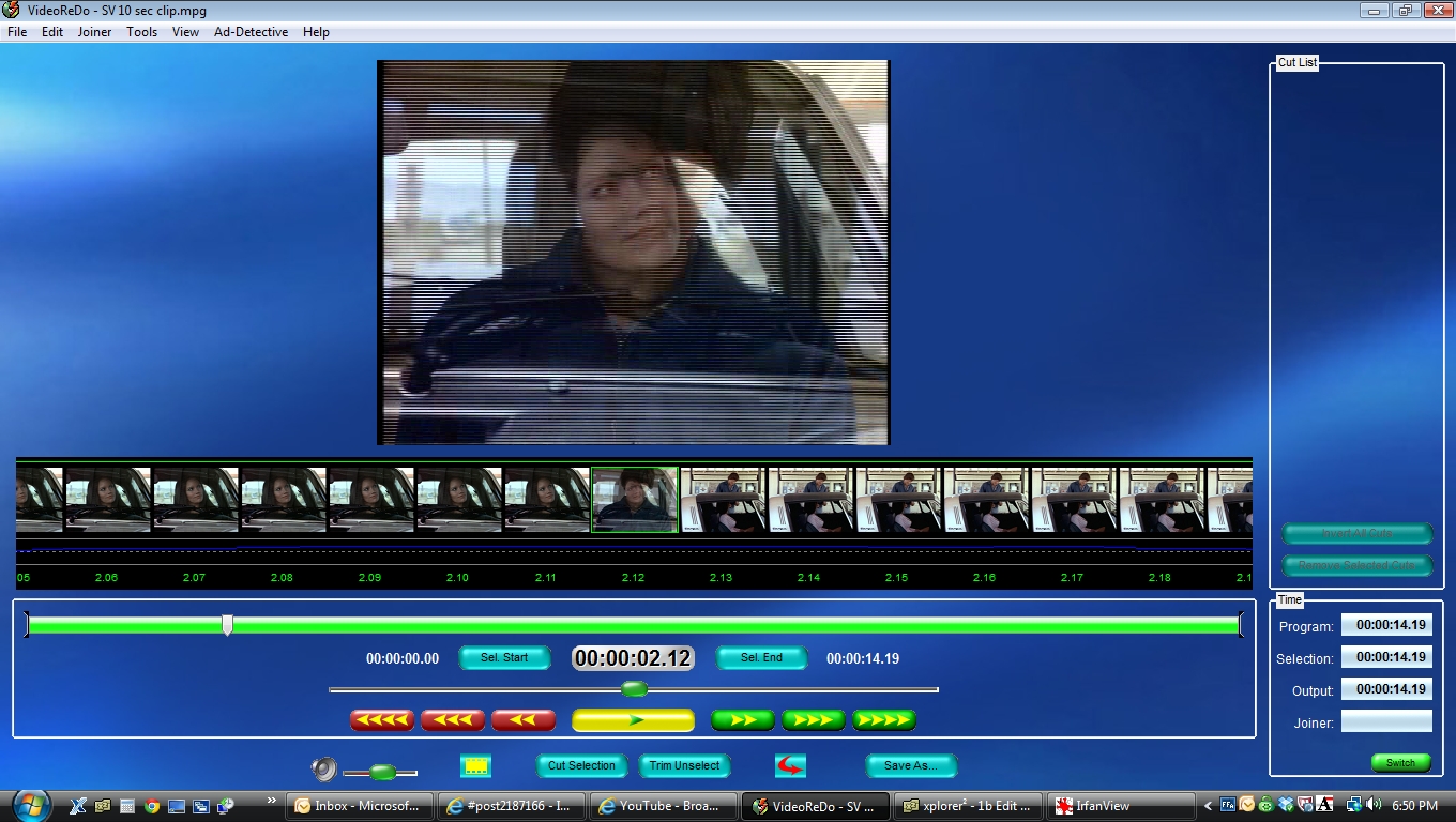

  8. Click image for larger version
Name:	Bad Frame as seen in VideoRedo.jpg
    Here is a screen grab of the bad frame in VideoRedo

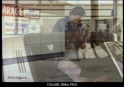

  10. Click image for larger version
    If you look closely you can see that this is not just a garbled frame. It is two pictures interlaced. One picture is the girl in the car and the other is the gas station attendant.

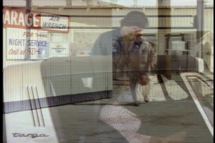

  28. By the way, even the original video has frames where one field comes from one shot and the other from the next. For example:
