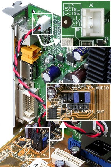

  10. With older Nvidia cards, like the 9400GT that I used to own, you could get sound from the DVI port with a DVI->HDMI adapter, but you had to connect the card to the SPDIF header on the motherboard.
    If there is a very small 2 pin socket on the card, it's likely to be the SPDIF input.
    See the picture:
