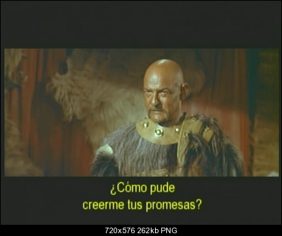

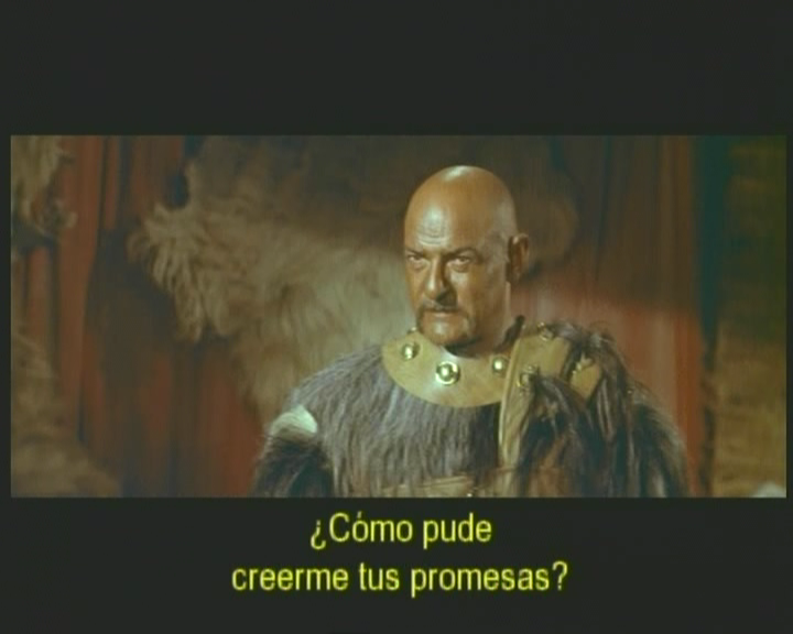

  1. Hello. I hope this is the right place to post this.
    I have a full DVD which is like this:
    The subtitles are hardcoded.
    How can i crop the image (the black bars up and down), so that the subtitles are cropped too?
    Maybe PgcEdit does that?
    Oct 2005
    666th portal
    no that is 16/9 encoded as 4:3 what is the end format you are looking to have? different tools for varying outputs. easiest is probably vidcoder using it's visual crop function to mp4 or mkv.

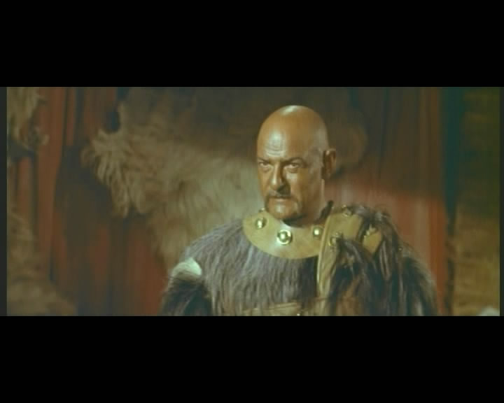

  3. If for DVD, AviSynth's Letterbox command:
    Letterbox(124,124)#although you can see from the grey along the sides, your black levels are all messed up

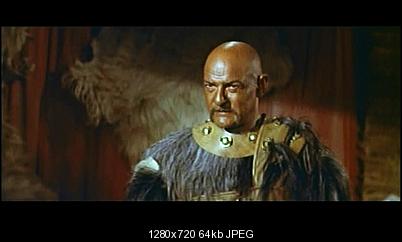

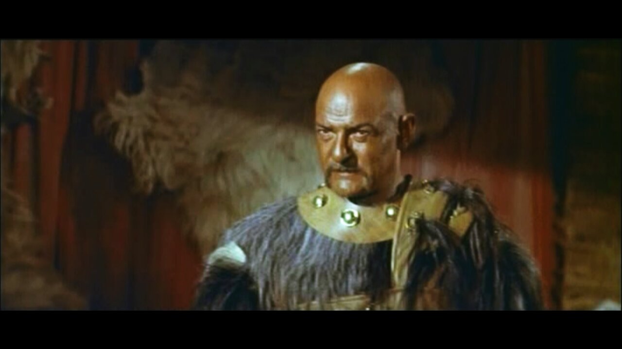

  24. Actually rob, i was thinking of cropping the video in my software, so as to convert 4:3 into 16:9.
    Do you think i'll have other issues afterwards? (eg. with the ifos of the DVD etc.)
    here's what I've come up with:
  25. Originally Posted by thinredline View Post
    If you try and create a 1280x720 DVD (like your picture), you will.
    Do you actually know how to both redo your letterbox and crop it down and resize to 720x576 for 16:9 encoding?
    But yes, lots of people convert 4:3 to 16:9 DVDs and don't have problems with the IFOs. If they know what they're doing. And don't be surprised if it doesn't look any better.
  26. yes, i won't create a 1280x720.
    i just exported the jpeg that way. i tried other default dimensions, and always it exported to 4:3.
    So, i exported to 1280x720 which i knew was widescreen.
    I'll have to look more into it, to find the correct dimensions.
    I just made this quickly..
    by the way, i could leave it to 4:3, and make it widescreen manually in my player each time I play the DVD.
    But since i'll go into all that trouble re-encoding, i thought i should change it from the start to 16:9, so as not to have to tweak it in my dvd player each time.
    edit:
    ok, the video exports fine in widescreen 720x576, but when i try to save an image it's not widescreen. I don't understand why. anyway, doesn't matter, as long as the video is ok.
