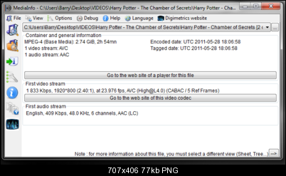

  3. Hi thanks for the reply here is the details.

    Actually given that info you posted you should be able to remux that video into an mp4 file and the xbox SHOULD be able to play it. However it has CABAC enabled so I don't know if it likes CABAC. You have 5 reference frames which should be ok I believe. I don't know what the upper limit is for reference frames on the xbox360 is but i know it doesn't like a lot.
    It is a base 4 profile so the xbox 360 should handle it remuxed into mp4 but there might be some more "under the hood" details on the file it might not like. But its worth remuxing to mp4 to find out.

    XBox 360 only technically supports 3 reference frames. I encode my MP4's with 3, but mediainfo always tells me there's 4 ... not sure why, but there you go. 360 may not be able to copy with 5, but couldn't say for sure as I haven't personally tested it.
    XBox 360 will also only handle 2-channel (stereo) AAC audio, and your video has 6-channel, so this definitely won't play natively. You would need to re-encode the audio to 2-channel.
