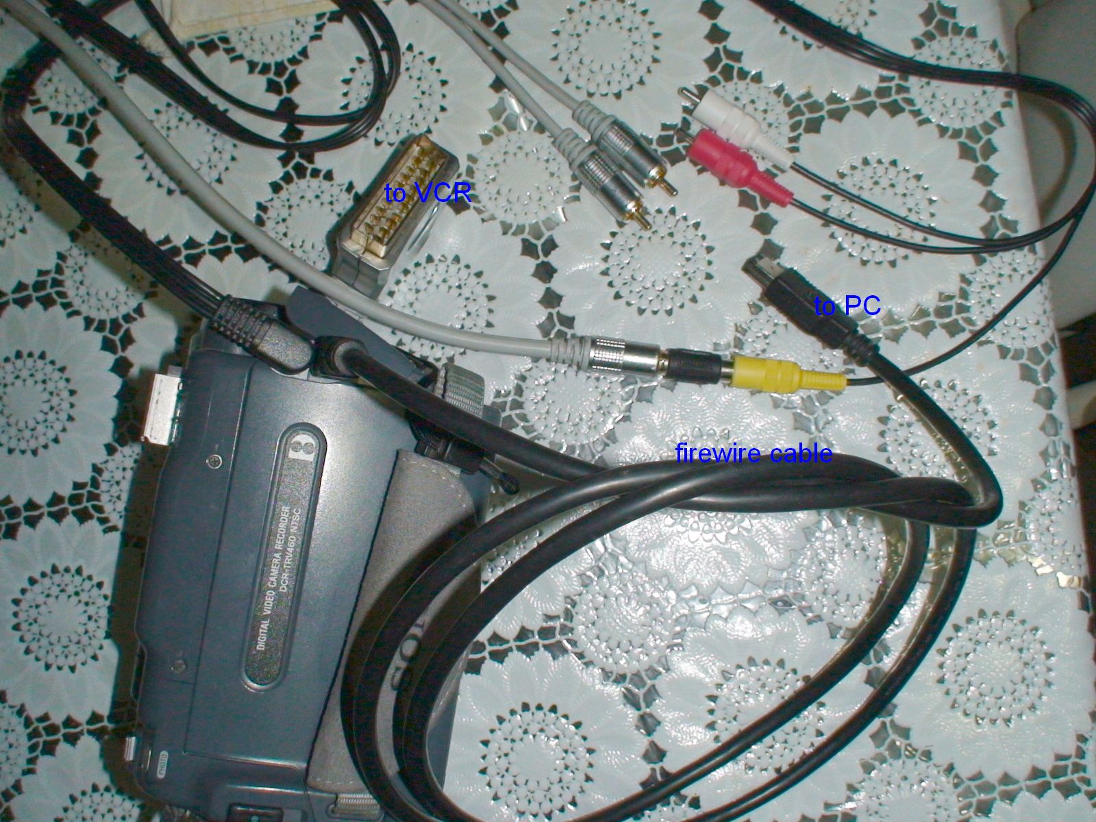

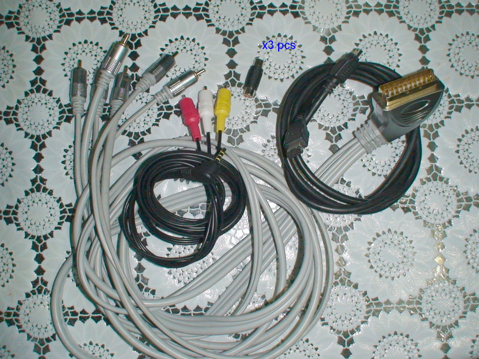

    To capture with your Canon HV you need:
    1. 3.5 jack with 4 pin and on other end 3 RCA, one yellow. one white, one red
    2. RCA adaptor female at both end 3 pcs
    3. SCART to RCA cable
    4. firewire cable, at one end with 4 pin (camcorder side). The other side fis for PC and can be 4 pin or 6 pin. Some firewire card have both type. Usually is with 6 pin.
    I hope that the picture are more easy to read.

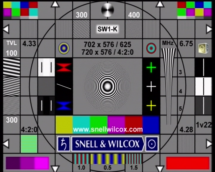

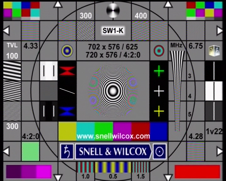

    Some tests from DVD player with an Canon MiniDV camcorder in A/V In analogue pass-through mode.
    First picture is with composite input. Dot crawl and rainbows are present. This kind of quality offer Canon HV40.
    Second picture with S-Video. To bad that Canon lack S-Video input.
    Click on picture for normal size.
Name:	Canon_composite_test pattern0000.png
Name:	Canon_S-Video_test pattern0000.png
