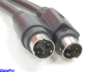

  2. Member hech54's Avatar
    Jul 2001
    Yank in Europe
    A good sign that you are looking at an S-VHS VCR is an S-Video connection on the back.....but not all S-VHS machines have them.

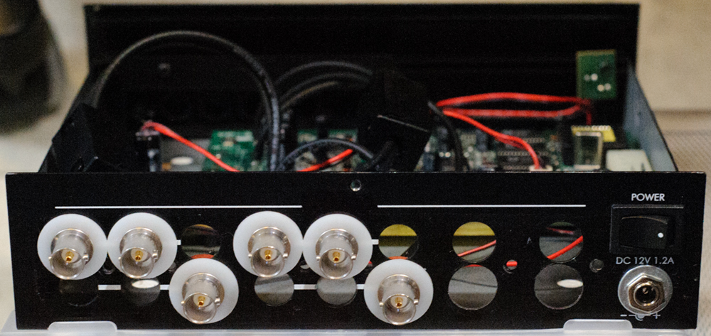

  25. Originally Posted by juhok View Post
    I've had pretty positive results by replacing S-video/DIN4 connectors with BNC connectors and using BNC video cable.
    Doing that entirely defeats the point of using the S-Video output. BNC is just the "pro" plug for a composite connection, if you rewire an S-video jack to BNC you're just converting it to composite. Unless I'm misunderstanding you, I can't imagine why you would rip out S-Video jacks and replace them with BNC.
    I have a dozen VCRs in rotation at any given time to perform my VHS digitizing, at all levels from cheap 2-head monophonic machines, plain SVHS with no TBC/DNR, SVHS with TBC/DNR, and DVHS with TBC/DNR. When playing ordinary low-res VHS, the difference between the composite and S-video connections is minimal or zero most of the time if TBC/DNR is inactive: sometimes the S-Video output is noisier, sometimes better. The difference between low-line S-VHS with no TBC/DNR and the higher-end units with their TBC/DNR activated is far more significant. (Of course, when playing true SVHS tapes all SVHS vcrs produce an upgraded image and it will usually look better using the S-Video connections, with or without TBC/DNR.)
    My Panasonic AG1980 and AG5710 (similar to PAL NV-FS200) have S-video and BNC jacks but no RCA composite. The S-Video connection in these units does offer slightly better PQ playing non-SVHS tapes, but not always. When connecting these "pro" Panasonics to most other consumer hardware, a BNC to RCA adapter cord is required when S-Video proves less desirable: depending on the cord or adapter, playback can be inferior to a consumer VCR using standard RCA composite jacks.
    Of the SVHS vcrs available second hand, 90% are basic consumer models with no performance upgrades over standard VHS models. In many cases in many countries there is a large price difference between these otherwise-identical units (i.e., a Mitsubishi HS-U448 might be $40 while asking prices for the HS-U748 SVHS might be $100). Since these basic-model SVHS vcrs offer no significant advantage, there is no added value to justify the price difference. Sure, if one can acquire the SVHS version at a very reasonable price, then it is preferable in terms of tape format flexibility. But I wouldn't recommend paying extra for an SVHS vcr to "improve" your regular VHS tapes unless you go all the way, and get a top model with TBC/DNR.
    A fancy VCR and cable does not magically improve your tapes from the usual VHS murk to "WOW!" quality. Achieving "WOW!" quality requires experience, skill, a range of hardware and PC software, and good quality source tapes. LordSmurf did not become LordSmurf overnight simply via the purchase of a JVC SVHS vcr: he became LordSmurf by doing a LOT of transfer projects over time. If all one has is two or three precious tapes that they want digital copies of with maximum restoration quality, it makes a lot more sense to pay an expert like LordSmurf to do the work for you. Risking money and wasting time rolling the dice on expensive used VCRs and testing different digitizing techniques and learning PC filters is silly unless you have a huge tape library and expect to make a long-term hobby out of converting them.
  26. Member
    Nov 2008
    Finland
    Heh, I'm using one BNC for Y and one for C. No conversion. Don't take me for a fool.
    This kind of setup for example fixed problems with cable reflection with TBC-100 (attachment)
    "But I wouldn't recommend paying extra for an SVHS vcr to "improve" your regular VHS tapes unless you go all the way, and get a top model with TBC/DNR." - Yes I would agree.
