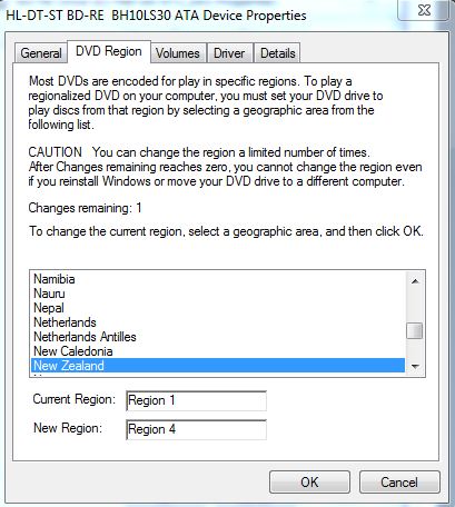

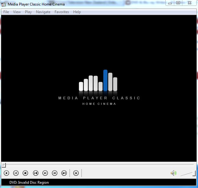

    i get this or when i try vlc player it just closes
    i have tried to change the region code on the dvd drive but get this
    any way to make it region free

  4. Member hech54's Avatar
    Jul 2001
    Yank in Europe
    Copy it.
    i want to make the dvd drive region free if i can
    Then you'd better hurry....you only have 1 change left.
    Easiest way out is to buy something like AnyDVD....or you can go the firmware route but it is not for the faint-hearted and if done incorrectly you can "brick" the drive.
    http://ala42.cdfreaks.com/MCSE/
  5. Banned
    Freedonia
    Ripping and reburning the DVD to a new disc will make it region free. We have various guides on how to do this.
    VLC ignores region codes so the fact that it barfed and died on your disc makes me have a lot of questions about exactly what this DVD is that you are trying to play on it. And I'm not sure you fully understand this - the NEXT time you change regions on your drive it is PERMANENTLY locked to that region. You shouldn't have EVER changed regions on it. You've been a member here for 3 years and posted more than 80 times. Why did you not ask for help or do research on how to deal with DVDs from other regions the FIRST time you had a DVD from another region? It makes no sense at all that you have just been changing regions on your drive multiple times. That is what people who aren't members here do because they don't know any other way to deal with the situation.

    i have tested about 5 other dvds in vlc player and they all work fine
    i have every season of home improvement and its only season six will not work
    Mar 2011
    Nova Scotia, Canada
    I suspect it's the dvd that's at fault. The media itself. Try the disc somewhere else.
    Vlc (or any other media player) should have no problem whatsoever with region codes. Even the crap ones I've used ... and, sorry, but I think mpc-hc is just one step above that ... don't give a fiddler's fart whether the source video is ntsc or pal.
