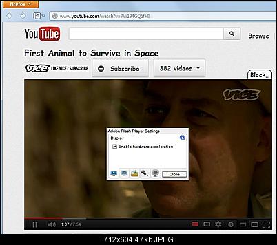

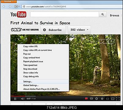

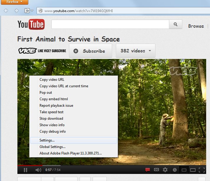

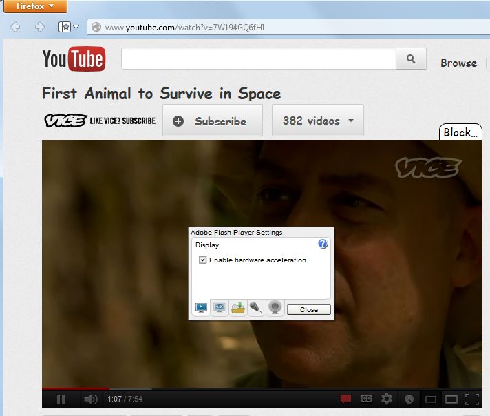

  11. Originally Posted by brassplyer View Post
    Try turning hardware acceleration off/on in Flash Player.
    Went to Flash player in control panel, don't see any option for hardware accel.
    Right click on the video while it's playing and select Settings:
  12. Originally Posted by brassplyer View Post
    I find if it's happening if I back up a bit in the timeline and resume play it stops doing it. What would be the explanation for that?
    Not enough bandwidth.
    http://speedtest.net/
    Look at the progress bar in the screen caps I posted. You can see that the download is far ahead of the player. Playing the 1080p version of that video I have the entire file downloaded before it's played 10 percent of it.
  13. Member brassplyer's Avatar
    Apr 2008
    I'm sure that's not it, I have a 10meg connection which runs between 8.5 - 9.5 megs. My progress bar runs well ahead of the video playback as well. Supposedly 1.5 megs is enough to play 1080p.
    So far having viewed a few vids after turning off hardware acceleration in Flash, I haven't seen it reoccur. Will report back.
