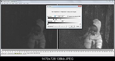

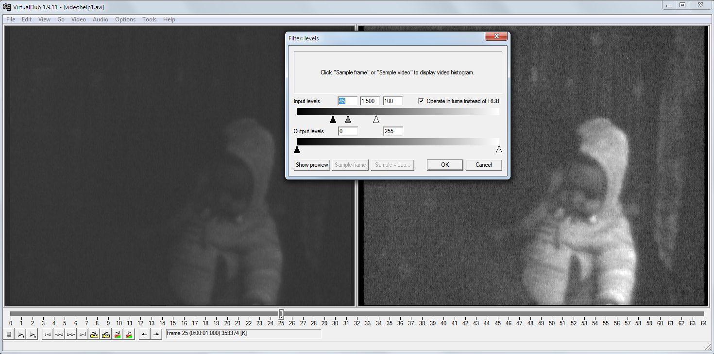

  7. There's more to work with there. Try the levels filter in VirtualDub. Or AviSynth. Unfortunately, there's more noise than signal so you'll end up with very noisy video.
    For noise reduction you might try intermediate levels adjustment, noise reduction, then final levels adjustment.
