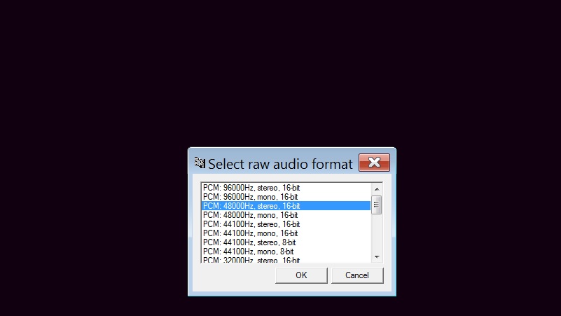

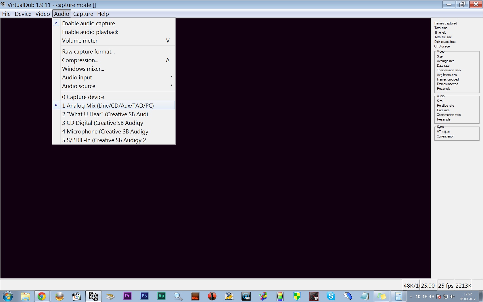

  1. I captured vhs to pc the audio to sound blaster audigy 2 zs pcm and 48000hz but audio seems very strange i never had that before audio from vhs directly to tv is ok only captured because i captured 3 hours I don't want to do it again can it be fixed in software here is sample. I capture in vdub 720x576 pal 48000hz 16 bit pcm wav audio.

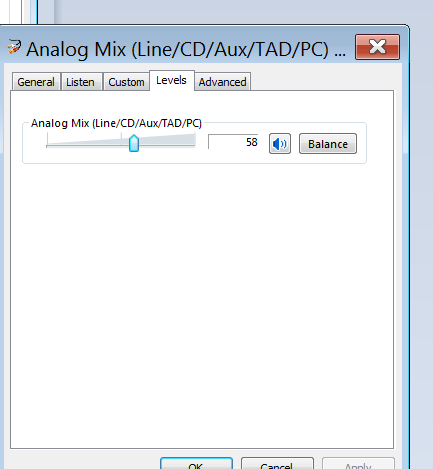

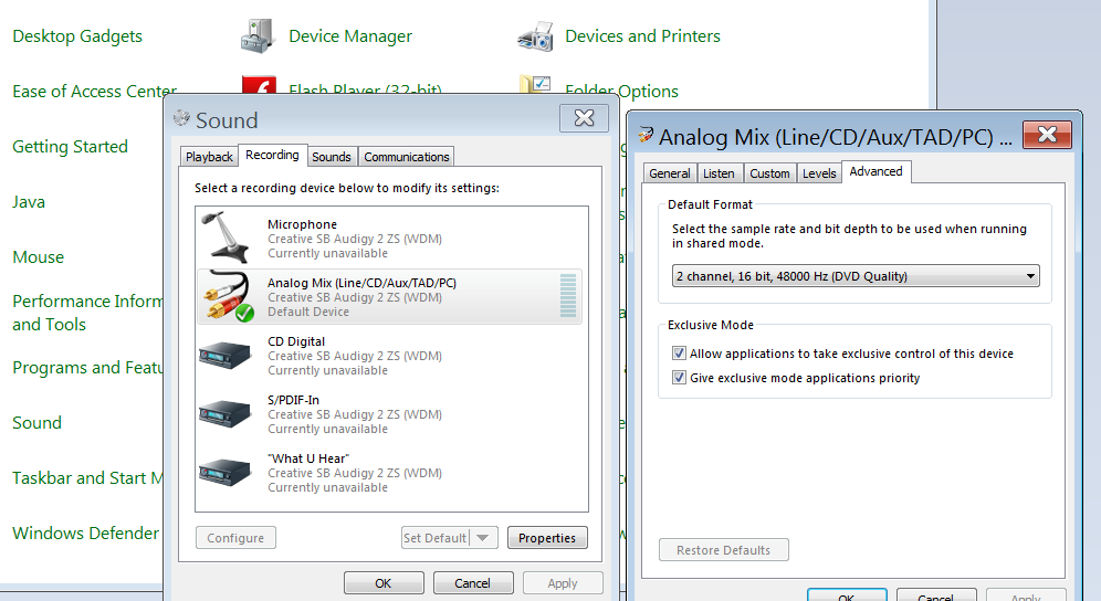

    that was i afraid of audigy 2z and windows (vista) 7 are pain in the ass i have to make some couple of setting to get it working
    not sure what audio card setting you've got wrong but you need to capture it again - it's missing half the audio and totally mucked up.
    i did everything by the book audio analog/aux in in audio console lower the audio so not clipping occur and when i heard it it is ok but when recording was mess up

  6. it is avermedia http://www.avermedia.com/product/ProductDetail.aspx?Id=463 but i think the problem is audigy 2z and drivers because if i record to motherboard sound is perfect if i return in audigy after that is ok ( it is like voodoo i don't know what happens to make it ok). The thing is that I think audigy mess it up with analog aux in out processing and might be something with the output if you put hdmi trough graphic card everything is ok, if you put spidif ( from sound card ) is ok if you put analog out ( headphones for example ) or speakers then it starts like this if i change to 96000 and 24 bit then it is ok if i return after that to 48000 16b it is also ok so it has to do something with driving the ports I guess ( im not expert on audio ). That happened to me also when i used my marantz cassette deck to dub to pc some old music that i had.
