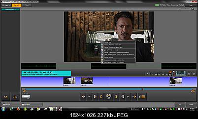

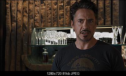

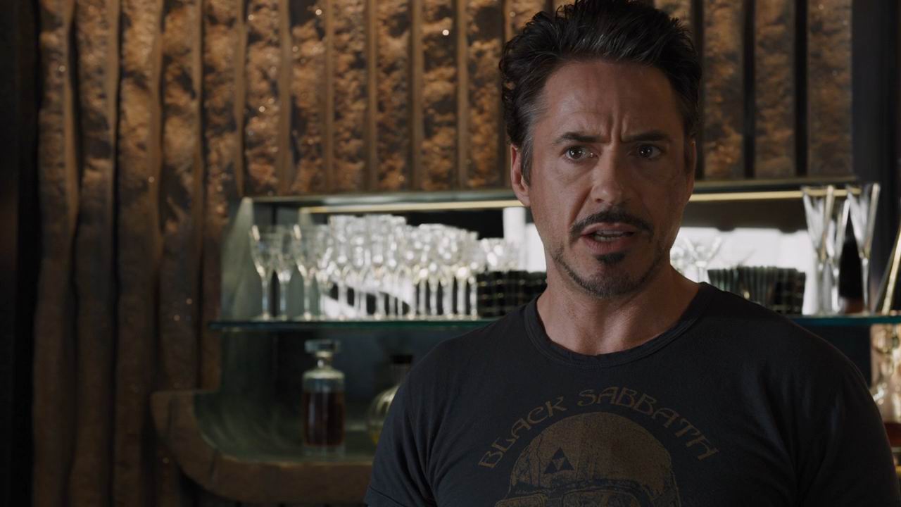

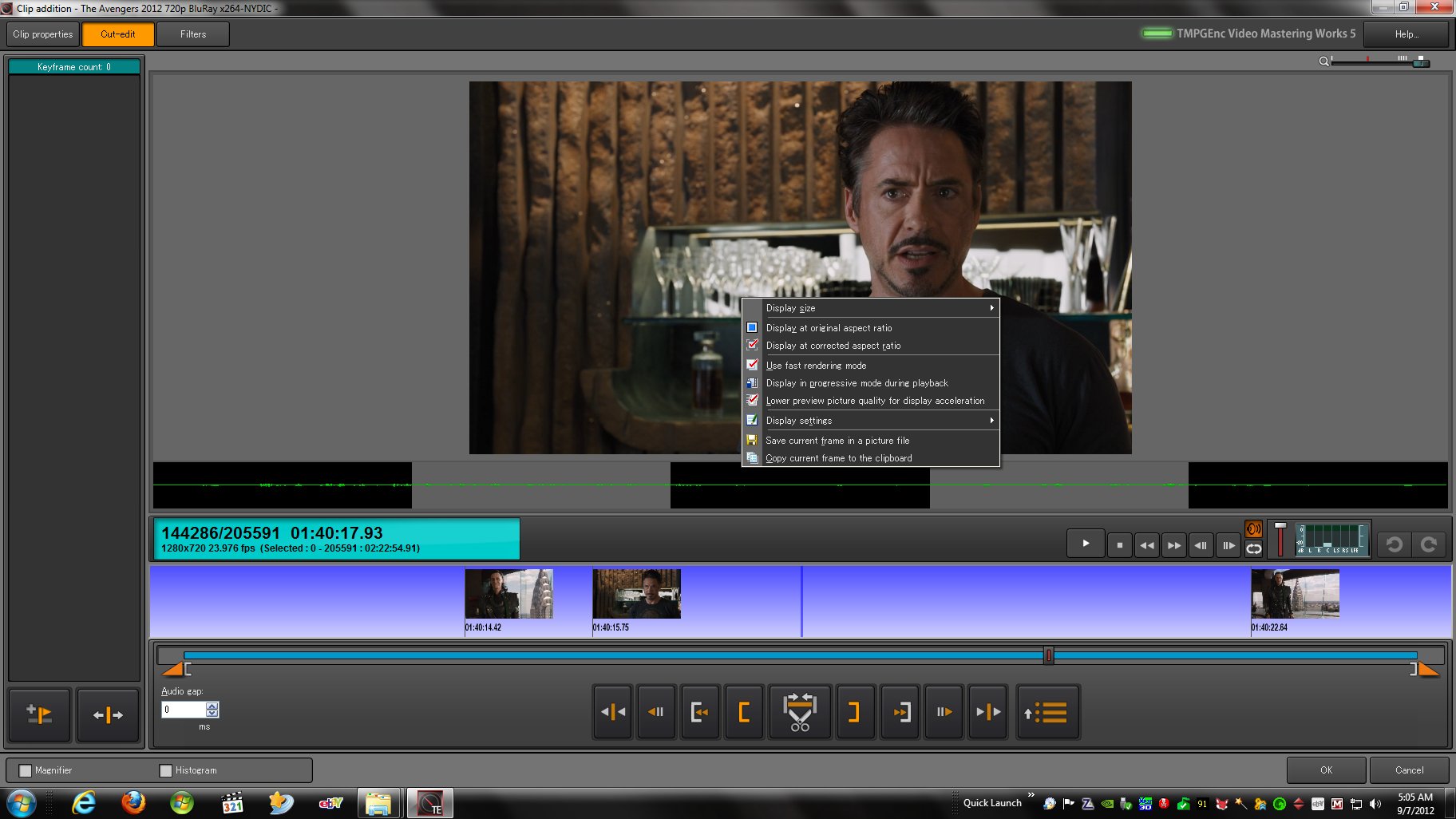

  12. Member lacywest's Avatar
    Aug 2001
    California
    Originally Posted by Matteo View Post
    Originally Posted by lacywest View Post
    Now ... if you want a program that works with MKV videos ... try ... TMPGEnc Video Mastering Works 5.0.6.38 ... I use it all the time.
    Can I capture screenshots with that software? Is there the key frames capture feature?
Name:	Iron Man talking ... Avengers.jpg
    Picture above is 1280 by 720

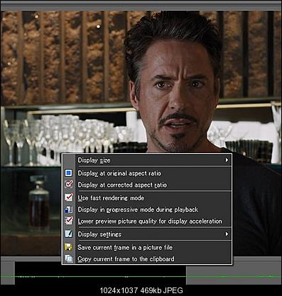

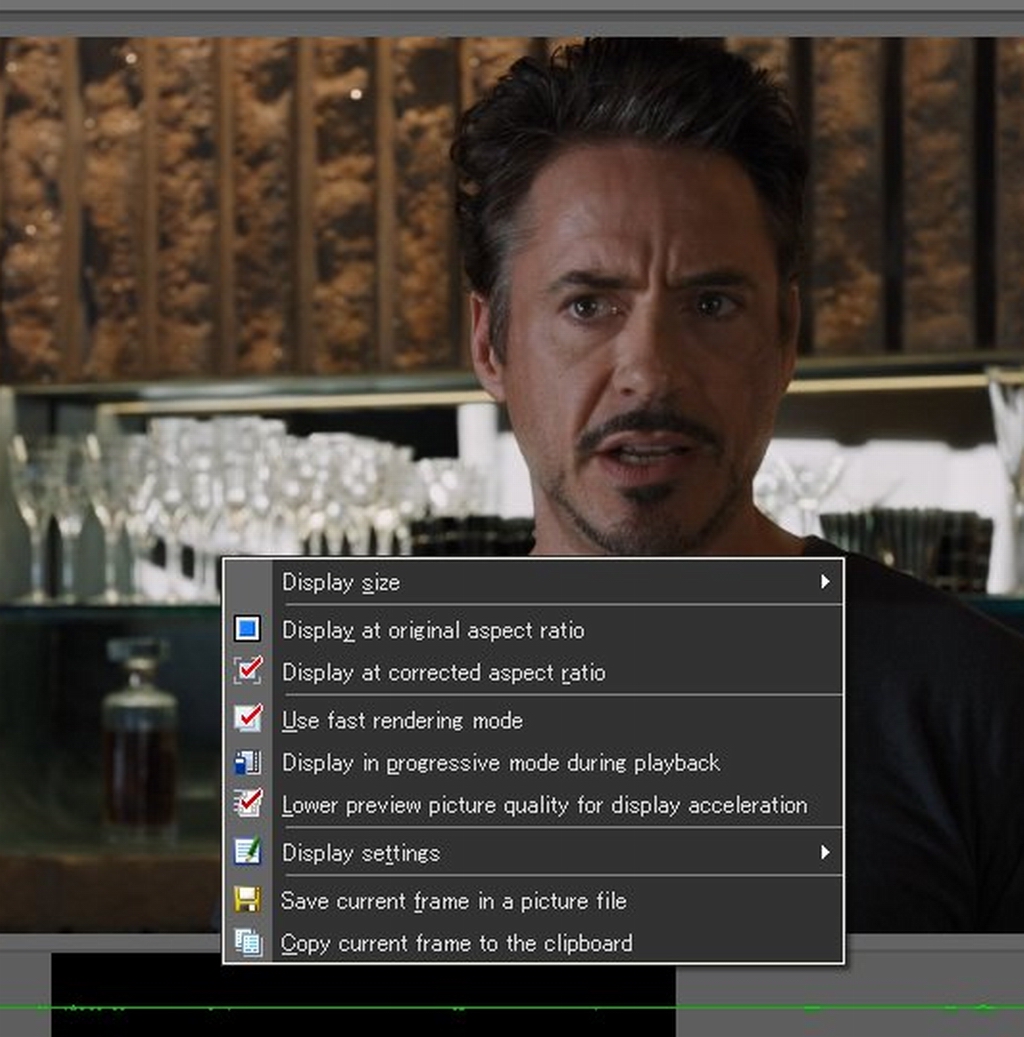

Name:	Sample of options.jpg
    Options are showing in the middle ... that is about all I can for capturing frames within this program.
    Here is a zoomed in ... section of the options
Name:	Sample of options - 33.jpg
