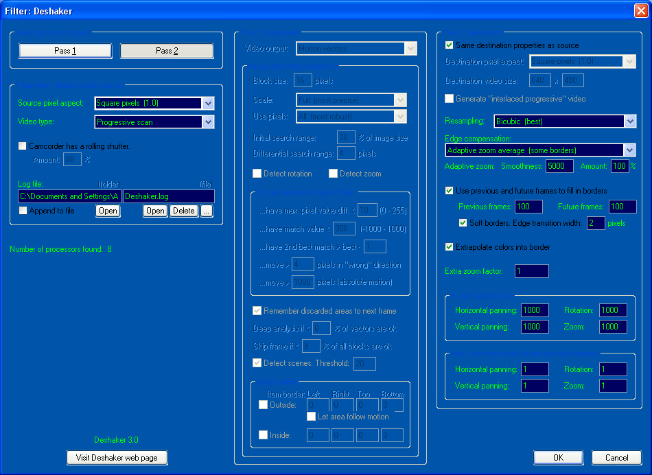

    I think this is the configuration I used, don't remember if I used 2 or 10 pixels for edge softening because I only wanted to quickly test results.
Name:	Deshake settings.PNG
