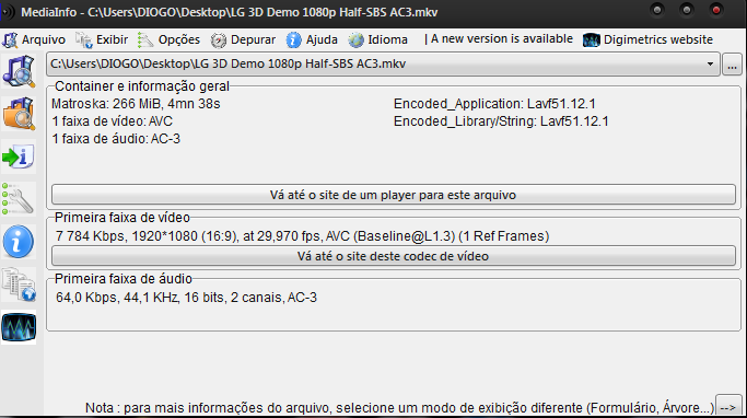

Source file

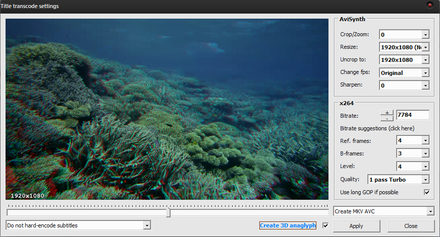

AVCHD without CUDA
File after conversion
Format
log file
Time of conversion was +-18min[19:26:27] Checking for available space and drive types (FAT32/NTFS)...

[19:26:31] *** Encoding : x264 options: --preset veryfast -B 7784 -I 60 --level 4 -i 8 -b 3 -r 4 -m 2 --mvrange 511 -A p8x8,i8x8 --ipratio 1.1 --pbratio 1.1 --vbv-bufsize 25000 --vbv-maxrate 20000 --qcomp 0.5 --threads auto --thread-input --aud --nal-hrd vbr --sar 1:1 --b-pyramid strict --slices 0 --weightp 0 --rc-lookahead 60 -o "c:\multiAVCHD\_TEMP\multiTEMP-20120909\LG 3D Demo 1080p Half-SBS AC3.[1920x1080-29.970].264" "c:\multiAVCHD\_TEMP\multiTEMP-20120909\20120909-192631-uncrop-running.avs"
[19:43:28] *** Speed : 8.21 fps (elapsed: 00:16:57 - Realtime x 0.27)

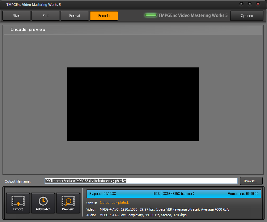

TMPGenc with CUDA
Format

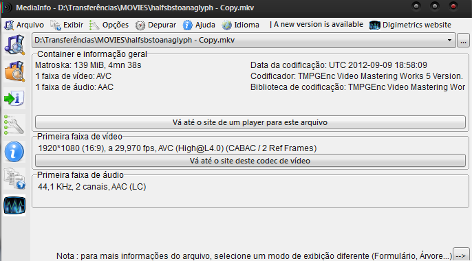

Time of conversion was +-15min
Images
https://forum.videohelp.com/images/imgfiles/sZmBW,Gzs9E,b8I5U,aiEAB,7rOkX,mIzEc,fzc1u,...,a1Ncd,veXgY#3
Conclusion
The time of conversion was similar (maybe because of the source file size). On TMPGenc there is no color change, in one hand is good, but in the other hand, the red based colours (LG logo for example) are "agressive" to the eyes when you put the anaglyph glasses (homemade). On AVCHD the colours change and doesnt exists red based colours "agressive", but the colour contrast is poor (all colours are, somehow, darker, less enjoyable)
