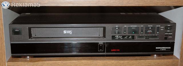

  1. Are this svhs machines any good for restoration and vhs to dvd capturing both are pal model and presumably copies of some pana or jvc models but i cant find more about it
    here some pictures of them http://www.ebay.de/itm/ws/eBayISAPI.dll?ViewItem&_trksid=p4340.l2557&item=261013958442...#ht_581wt_1402

    Blaupunkts are usually Panasonic clones....Metz too.
    Philips had some JVC clones. I bought one recently(VR 1100)...NICE machine.

    Blaupunkt VCRs are not clones, they are rebrands. It's the same internals with a different label made by Panasonic for Blaupunkt. RTV-915 should be Panasonic NV-FS90. I wouldn't want one if they came for free - which they usually do.

    In this case rebrands use same parts. Internals are the same. This is pretty common knowledge and with some googling it's possible to find the charts describing the common models (Panasonic<>Blaupunkt<>Metz<>Loewe). I got one Blaupunkt myself for spare parts for it's Pana counterpart. A guy from Germany told me that they needed (also) to be sold under Blaupunkt brand because some people had strong affection to the brand and so I guess Panasonic brand would've been seen as inferior product (and Blaupunkt didn't make their own high-end VCRs).
    Your second question I don't quite understand. Do you mean to ask why FS90 is not a good VCR? I personally don't like those ancient decks. If you need one, get FS-200, it's not like they cost much and at any time many are for sale on eBay. IIRC FS90 doesn't even have a TBC.

    I have no knowledge of USA models so I can't comment on them. But FS-100 doesn't have TBC. Nordmende v8005 is a complete stranger to me. I know only about those that I use / find interesting.
    Here's some info about newer models http://www.digitalfaq.com/forum/video-restore/1567-vcr-buying-guide.html (OP missing many additions from the end of the thread)
    Here's older Pana<>Bp http://www.hifi-studio.de/hifi-klassiker/panasonic_nv-f70.htm
    Some of the more complete ones I've lost and don't want to spend an hour on this.
    (HS-1000 = Blaupunkt RTV-965, Loewe OC-3800)

    I have two of these in the loft. I was always told that they were a rebadged JVC HR-S5500. Certainly, I used my JVC remote with them all day long with no worries. Last time I plugged them in they gave a very snowy picture. I kind-of hope that they'll rejuvenate themselves after a bit of a clean.
