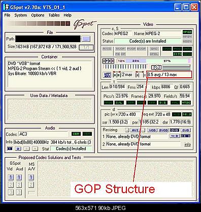

  1. How to create this kind of GOP Structure... IDK how to create this 8.5 avg/13 max
  2. Banned
    New York, US
    Create it from what?
    There is no "8.5" GOP structure; that number is an average figure for the VOB file that GSpot is analyzing. A GOP is a "Group of Pictures", so you can't have "8.5" pictures. GSpot is saying that the GOP organization in the VOB file varies from time to time, with 13 being the max GOP size for your sample video. The GOP size is usually set during encoding from source to MPEG2.
