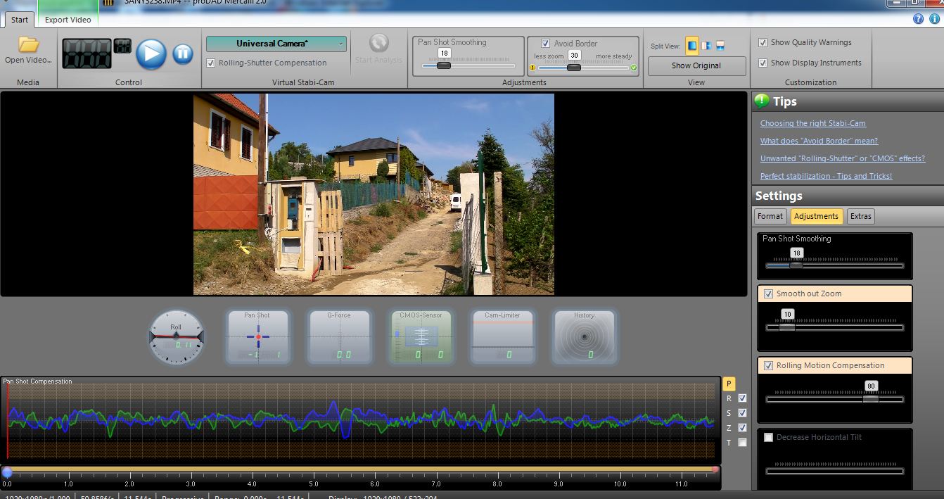

    I have tried to stabilize some of my video files that I liked but lacked good stabilization by the camcorder. I used Mercalli 2.0 stand alone stabilizer software. Mostly the results were very satisfying, but there were some videos where the program was not successfull in 100%.
    I uploaded an example: the original video and the Mercalli software output, too. My problem is that, in this software, the most important setting is the "pan shot smoothing" bar. It makes most of the work. When I set it low, the image is still shaky. Around 20, the shakiness reduces in case of my videos to a level that is okay for me. However in case of this particular video below (unlike in my other videos), simoultaneously, the picture becomes a bit wobbly here and there. It is not too wobbly, but you can notice it. Can this wobble be eliminated somehow? I also included a screenshot here about how I set the software.
    Maybe this software is not enough for this video, and I should use one that is more advanced. Like Virtual Dub Deshaker. If that is the solution, what parameters do I have to care about to get rid of the wobbles?

    The "jello" is already in the original footage . It's just made worse by the software. Watch it again, or look at it frame by frame - you will notice objects wiggling like jelly in the original footage
    First you should read up on what rolling shutter is. It's crucial to your understanding. The short explanation is different parts of the frame are scanned at different moments of time. So by the time the middle part is scanned, the camera has already moved. That's why you get skewed objects
    When you use a software stabilizer it tries to make the footage more steady. The problem it can only fix the whole frame (move up, down , left, right of a single frame) , not parts of a frame. The rolling shutter artifacts affect portions of the frame. So when it tries to apply corrective action the end result can actually look worse - sometimes it looks like objects vibrate or "phase" in and out , this isn't shown well in your example, but when you process more footage you will see it.
    A "real" solution would detect and adjust different parts of a frame. This is almost impossible to do "automatically" with any accuracy, because not only do you have to know scan rates, you have to re-calucate different velocities and motion vectors for different parts of the frame (e.g. and object

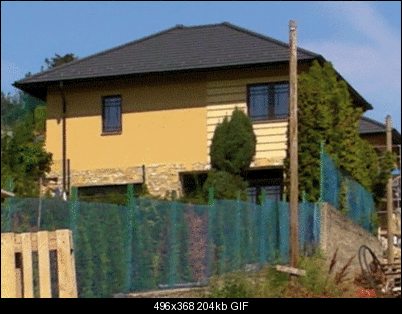

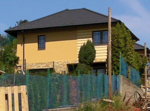

  11. Here is an animated gif cropped from the original footage - do you see the objects warping? Look at the pole. The top half moves differently than the bottom half. But it's a single solid object !! It should move together . This is the basis for rolling shutter problems
    Stablizers like deshaker, mercalli - they track feature points . They track motion vectors of various objects travelling in sucessive before/after frames. They can get confused if an object moves in left, but suddenly moves the opposite direction, but other objects move in another direction and magnitude. How can the same single solid object move with different velocities ? So the corrective action sometimes makes things look worse - which motion vector should it pay attention to? Which direction is the frame moving in (in relation to the surrounding frames)? It's hard to say because the individual motion vecotrs are all over the place , they are not in accordance with each other. When you factor in zoom (as in this shot), it messes up things even more
