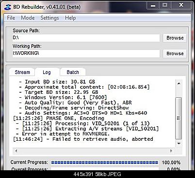

    I cannot get BD Rebuilder to work, I get the following:

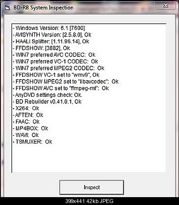

    The BD Rebuilder Inspection looks okay. I have enabled VC-1 and the other recommended setting have been done. I have researched this error(s), but still can't pinpoint where I went wrong.

  2. Rip it again. Then see if you still get that error.
    Here's what jdobbs has said about the likely cause of that particular error message:
    "That error is coming from TSMUXER -- it is saying that one of the streams (usually an audio stream) has buffer requirements that aren't reasonable for something compliant with BD. That normally means a bad rip."

    I've ripped or tried ripping like 4 times. bad disc? Is there an alternative to this method?
    One thing I have noticed is when I have BD Rebuilder open, it won't let me check a particular Audio Selection. I can check the others, but this one. Should I leave the unchecked unchecked?

  4. Hmmm, unless it's a bad disc, as you say, it seems tsMuxer just doesn't like one of the audio streams. You could of course have a run with it unchecked.
    Have you used BDRB successfully before? Are you doing full disc or main movie? If main movie, you could extract the movie first with Clown_BD (an eac3to GUI), which can sometimes fix a buggered audio stream.

    This is actually quite possibly the damn DTS EX problem where DTS EX audio makes BDRB freak out and die. It needs a special config option to fix it. Why they don't just make that part of the config by default is beyond me. It's just another puzzling question I have about the author and his thought process. Try this. Go to the directory where you installed it and open the BDREBUILDER.INI file with a text editor (Word, WordPad, NotePad, etc.). Add this line to it:
    DTSX_ENABLE=1
    It doesn't matter where you put it, but I put it after the KEEP_HD_AUDIO=0 line. Save the file. Restart BDRB and see if it magically fixes your problem.

    @fritzi93: This is my first time using BD Rebuilder. I changed the output to BD-25 and updated AnyDVd HD. I think I finally got it.
    @jman98: I will try that, should it fail, but it looks promising. Man, it does take a while.

  7. Okay, so it *was* a bad rip...in a way. That's a good reminder to keep up to date.

    I re-read this and it made me remember that I think I had this exact problem after ripping with AnyDVDHD. I had actually done an update and not used it for a few weeks and then when I used it again, the rips I made with it all had problems. Fortunately a new release came it, I installed it and it fixed my problems.
    Keep the DTS EX fix in mind. As this becomes more common if you do full backups you will eventually get bit by this until the author makes handling it part of the default configuration.

    Well, this reminded me that I had shut off AnyDVD. Once running again, the error stopped.
