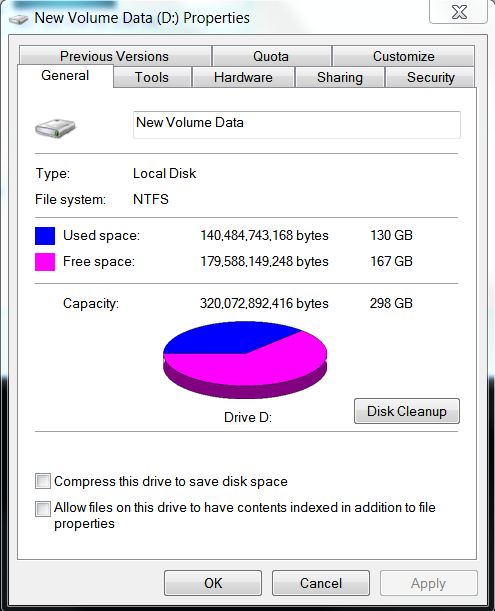

Yes. Sometimes it takes a few minutes to open the secondary drive; the green progress bar on the address bar hardly moves, and if I open a folder inside the drive is also slow, then click on the back arrow to go back to the drive It's slow again.
I'm using W7 64. I just installed new 8GB ram thinking that was the problem. I have also re installed OS and done all the updates, and still haven't installed all my hard core software: Office, Cam/Cad and multimedia software.

	Yes, the problem persisted after full clean installation and with nothing installed just the OS. I disallow indexing on the drive and it improved about 40%. Sometimes it opens to the click of the mouse other times it can take from 3 to 5minutes and keeps doing it as you hit the back arrow. This doesn't happen on W7 32 installed on the same HDD. Never had Boot problems nor mayor other problems.
