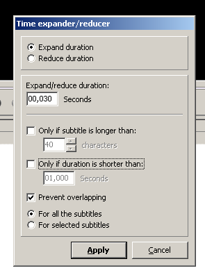

  17. Member AlanHK's Avatar
    Apr 2006
    Hong Kong
    1) Add 30 ms to every subtitle (Edit -> Timings -> Time Expander/Reducer).
    2) Fix overlaps (Tools -> Information and Errors -> Information and Errors).
    3) Subtract 30 ms from every subtitle (Edit -> Timings -> Time Expander/Reducer).
    Actually you don't need step 2; in step 1 use the Time Expander option "Prevent overlapping".
    (Using version 2.52 at least.)
    But you also need to set the minimum gap in the program settings to 1 ms (default is 300).
    Then the timings change like this:
    original
    00:00:00,000 --> 00:00:04,399
    00:00:04,400 --> 00:00:06,000
    00:00:06,030 --> 00:00:08,000
    expand 30 ms (note: "prevent overlaps" means the 1st sub does not change)
    00:00:04,400 --> 00:00:06,030
    00:00:06,030 --> 00:00:08,030
    reduce 30 ms
    00:00:00,000 --> 00:00:04,369
    So now gaps less than 30 ms are expanded to 31 ms.
    Image Attached Images
  18. Originally Posted by AlanHK View Post
    I missed that!
