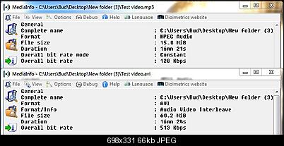

    To check if this is a problem use a demux to produce separate audio and video (mediainfo won't catch) and check the length of each like below:
Name:	ScreenHunter_121 Sep. 24 09.23.jpg
    If I find this, I usually use Virtualdub, select video-->frame rate and check make audio/video equal length, check playback and then combine them.
