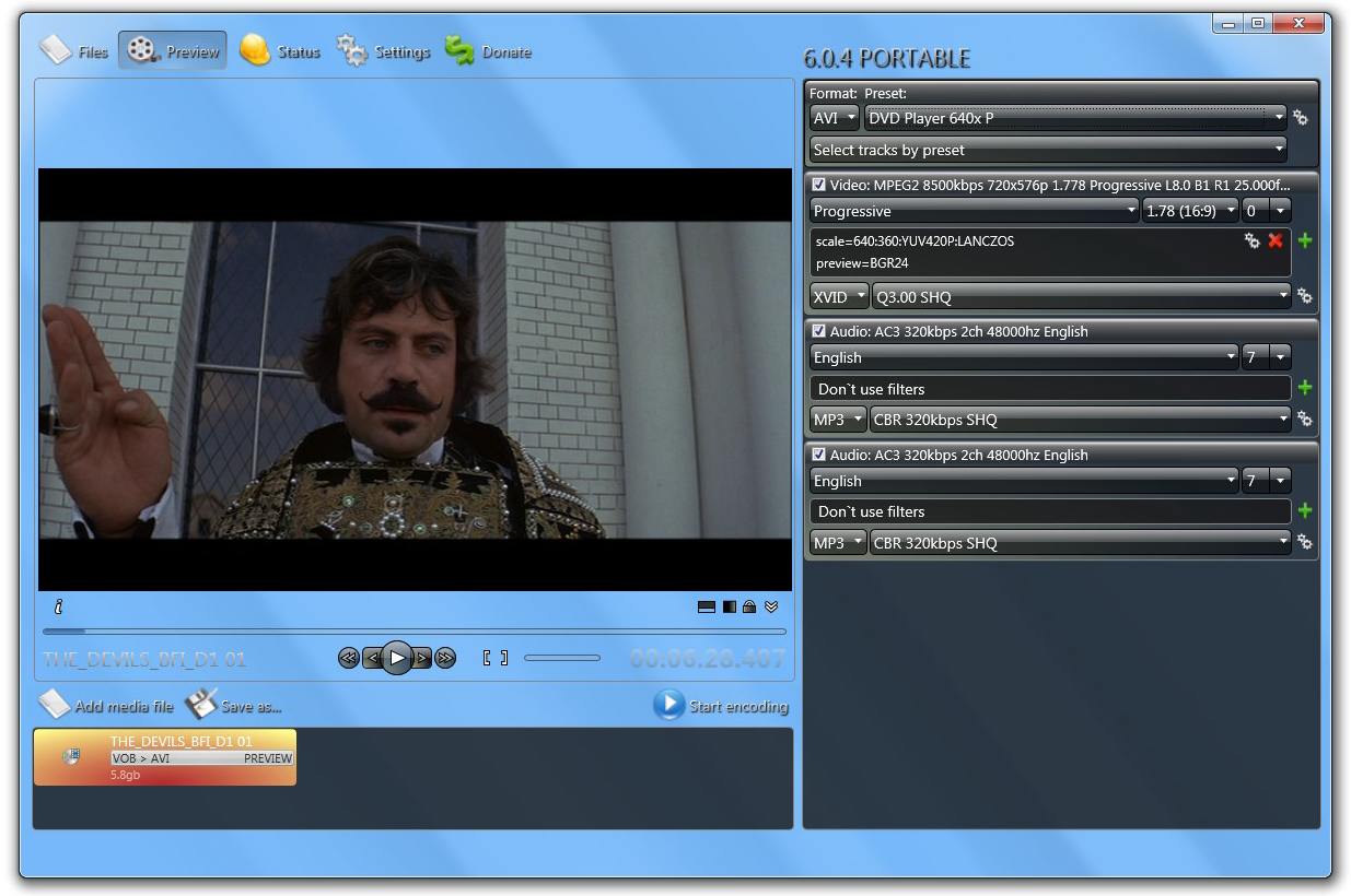

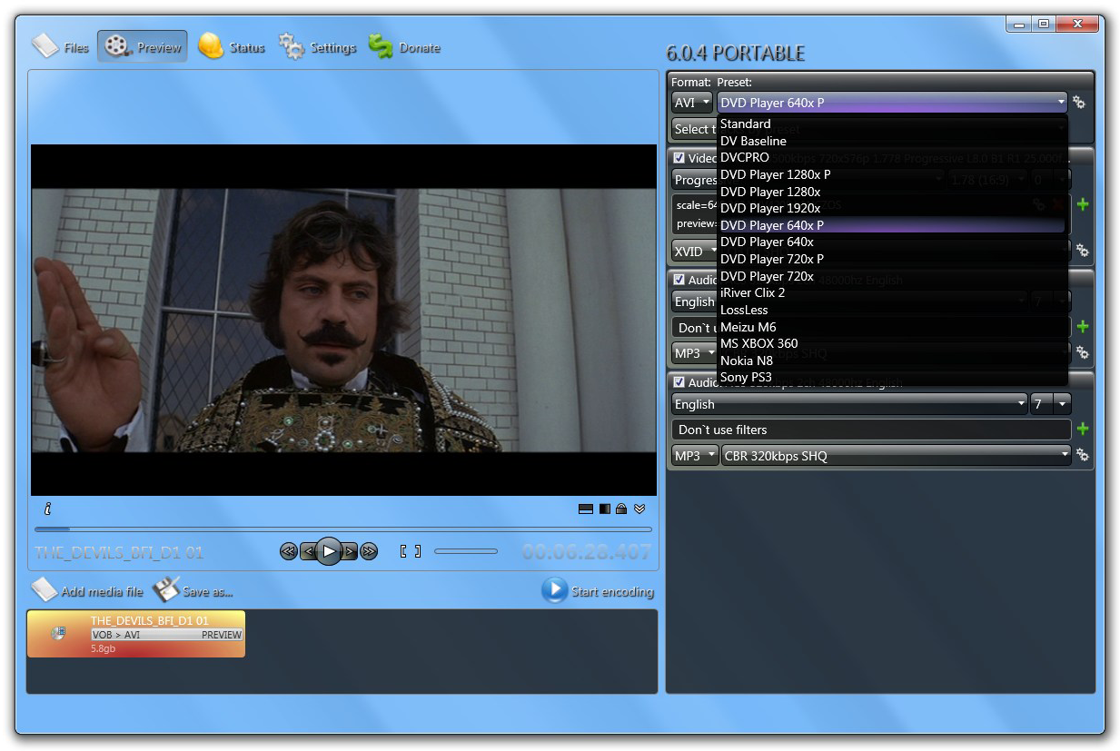

Well if you are going with DivX / XviD AVI then I suggest NOT using Handbrake.
autoGK is a popular one for doing that type of encoding (I used to use it myself in the past) and another good one is XviD4PSP which also works very well and has a lot of options (these days that is what I would use instead of autoGK when doing AVI files of this type).
Here's a screen shot of XviD4PSP 6.04 Portable
As you can see in the first screen shot there are various AVI setting. Your device probably only handles SD resolutions (I'm guessing) so you would want to pick one of the DVD 640x or DVD 720x choices. 720x is better if it is supported by your device.
Anyway those options will create an AVI with the proper settings.
Here's a MediaInfo output of an XviD AVI that was encoded using XviD4PSP
By the way you can RIGHT CLICK with your mouse on any of the two images above and select "Open image in new tab" to see the original full resolution (the image gets resized to a smaller one here in the post)Code:General Complete name : J:\VIDEOS\samplevideo.avi Format : AVI Format/Info : Audio Video Interleave File size : 23.1 MiB Duration : 53s 808ms Overall bit rate : 3 606 Kbps Writing application : XviD4PSP 6.0 / 53.6.0 Video ID : 0 Format : MPEG-4 Visual Format profile : Advanced Simple@L5 Format settings, BVOP : 1 Format settings, QPel : No Format settings, GMC : No warppoints Format settings, Matrix : Default (H.263) Codec ID : XVID Codec ID/Hint : XviD Duration : 53s 679ms Bit rate : 3 344 Kbps Width : 640 pixels Height : 360 pixels Display aspect ratio : 16:9 Frame rate : 23.976 fps Color space : YUV Chroma subsampling : 4:2:0 Bit depth : 8 bits Scan type : Progressive Compression mode : Lossy Bits/(Pixel*Frame) : 0.605 Stream size : 21.4 MiB (93%) Writing library : XviD 64 Audio ID : 1 Format : MPEG Audio Format version : Version 1 Format profile : Layer 3 Mode : Joint stereo Codec ID : 55 Codec ID/Hint : MP3 Duration : 53s 808ms Bit rate mode : Constant Bit rate : 256 Kbps Channel(s) : 2 channels Sampling rate : 48.0 KHz Compression mode : Lossy Stream size : 1.64 MiB (7%) Alignment : Aligned on interleaves Interleave, duration : 24 ms (0.57 video frame) Writing library : LAME3.98.2
