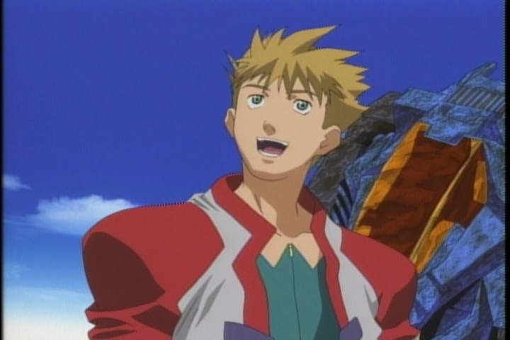

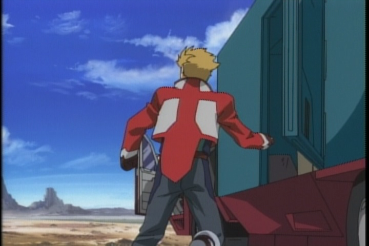

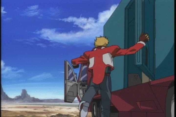

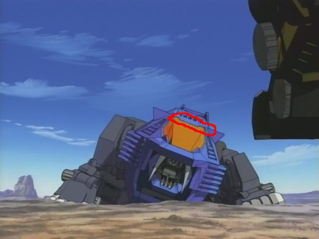

  1. Ive seen and fixed plenty of dot crawl in sources but this really takes the cake at being a pain in the ass.
    Perhaps its not dot crawl or something Ive not yet come across?
    These lines during playback seem to have plenty of moving dots running along the lines. It looks pretty much like dot crawl to me but seems a little different.
    I used the dot crawl filter checkmate() and an antialiaser and they still wont go away. They seem to be around a bit less after though.
    Its several times more noticeable in the DVD video source. Theres an unaltered video sample in the next post below.
    any suggestion? Here are a few screenshots of the source after I have filtered it with checkmate() and an antialiaser. (Unaltered video screenshots can be found below)
    http://img59.imageshack.us/img59/4408/dot1.png
    http://img11.imageshack.us/img11/6936/dot2p.png
    http://img839.imageshack.us/img839/1805/dot3.png
    http://img14.imageshack.us/img14/4271/dot4.png

  2. Heres an unaltered video sample incase anyone needs it.
    They show up alot once it gets to around the point you see the guy wearing the red jacket. They show up like that in various places all through the entire video and DVD.

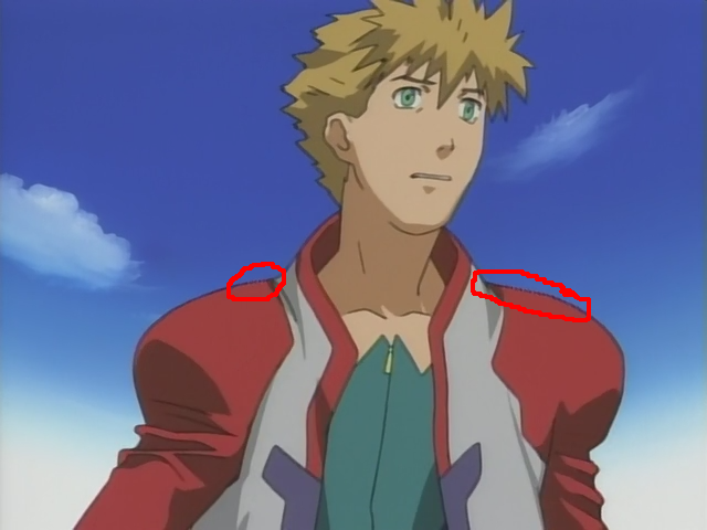

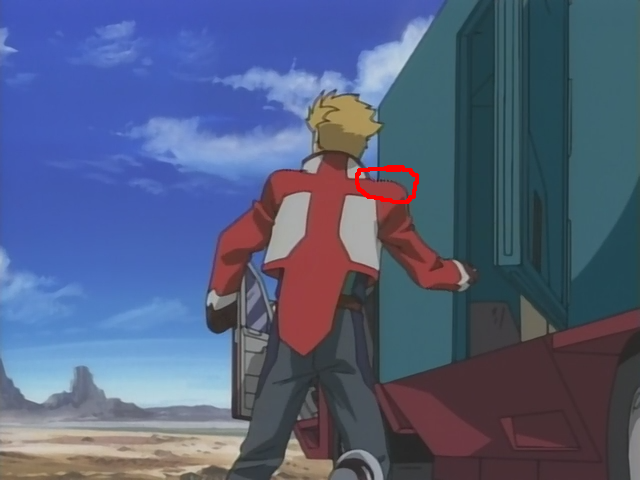

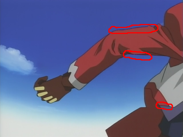

    heres a couple screenshots too of the video unaltered
    http://img528.imageshack.us/img528/2756/vts011vobsnapshot021520.png
    http://img803.imageshack.us/img803/2756/vts011vobsnapshot021520.png
    http://img17.imageshack.us/img17/3065/vts011vobsnapshot062020.png

  3. Those are left over dot crawl artifacts from a poor dot crawl filter. They are very hard to get rid of without destroying the rest of the picture.
    Scot Elliott's DotCrawl Comb Filter for VirtualDub does a pretty good job of removing them from your video. But it also leaves some other artifacts.

  7. Actually, I finally got it quite well and I didnt even have to ruin much if anything that I can see. I dont notice anything going bad about it really.
    TOP = My original encode that I posted shots of with dots
    BOTTOM = The one I just did last night that I was going to see how it turned out
    Ok in this first example, 99% of the dots are gone and I didnt really notice anything ruined about it. The new one even looks a bit sharper I think. If you look around the eyes, it looks like the new one might have darkened/thickened black lines in some areas of the video a tiny bit but no one will really notice during playback unless they had the original footage to compare to it. I could barely tell in the screenshots.
    Thats much better than the original footage as you can see
    In this next example again 99% of the dots are gone and I dont really see anything gone bad yet. Again I think I see black lines barely getting thicker/darker in some spots but without footage to compare and being picky I dont really think it means too much or is a bad thing. The only real change I notice between the two besides the dots gone is the bottom left corner of that opened door when I flip back and forth between the two quickly.
  8. So what filters did you use?
    I added in
    checkmate(tthr2=0) ------- [[[did (tthr2=0) so artifacts wouldnt show up during rapid movement]]]
    QTGMC(preset="Slow", InputType=1) ------- [[[This is what I added in last night that took away the rest of the dots with ease]]]
    and I added an antialiaser of my choice, a denoiser of my choice, and a sharpener of my choice at the end to get rid of the rest of the dots and to sharpen the image. The antialiaser and QTGMC are what got rid of them completely. In my first encode I only had the antialiaser and checkmate without QTGMC. They reduced them but didnt fully get rid of them alone.
