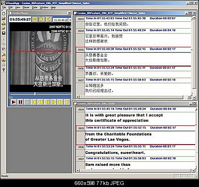

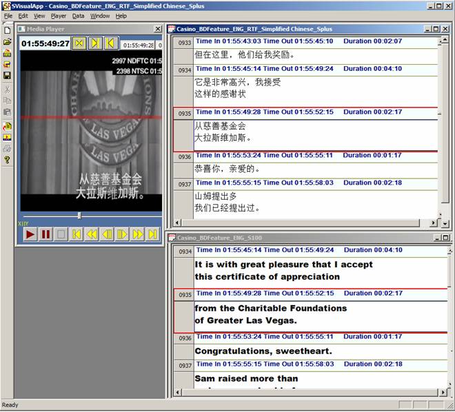

  5. I am afraid that there is not a perfect solution for yourcase. we sometime have to redo everything (copy and paste every subtitle data to build anew data list)
    For you case, SutitlePlus"Bind" function may help a lot, www.subtitleplus.com
    SutitlePlus has "Bind" function, which let you tobind two data list (like English and French"), so that it automaticallydisplays the subtitles according to the closesttime in two data lists. which helps the user to edit the subtitles at same time.With "bind" function, The user does not look for where is thecorresponding subtitles each other.
    Subtitle Plus do have "compare function" forinternal use at this point, but it wont help much in your case.
