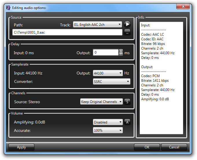

In XVID4PSP it defaults to normalizing the audio in a really stupid way. I turned that off when I extracted the WAV file. So here is how you do that ...
Following my directions above, after switching the FORMAT to AUDIO ...
You have to set the AUDIO ENCODING to what type of output you want. In this case I would just go with AC-3 but the OP wants PCM WAV so you select that from the drop down list on the left where it says AUDIO ENCODING (the option is called "PCM 16bit" to be exact).
After you do that you have to go to the top where it says AUDIO and under that select PROCESSING OPTIONS. This brings up a new menu. Here you can select several things like the sample rate and number of channels (for instance if the original was 5.1 AC-3 you could downmix it to 2.0 Stereo or 2.0 Dolby Surround Pro Logic etc.). In this case the original audio is 2 channel and already 44.1kHz so we don't need to adjust any of that stuff. However you do have to adjust the VOLUME stuff.
There are two options under VOLUME:
1.) Amplifiying: 0.0db
2.) Accurate
I believe the default for Amplifying is 100% which basically normalizes the volume to 0.0db
The really stupid part is that the Accurte is set to 3%
So here's the deal. You can select "Disabled" for Amplifying and if you do that you are done. However if you do decided to do Amplifying then you first need to decide what amount. Personally I wouldn't do 100% but maybe 98% or 96% etc. but that's up to you. The most important thing is to then change "Accurate" to 100% or it won't do it properly.
In my case I set Amplifying to "disabled" and like I said I got a clean audio file with no dropouts or any other weirdness.
BTW here is what that screen looks like:
Again you get to this after selecting the type of AUDIO ENCODING you want by selecting that first (on the left hand side) and then you click on AUDIO at the top and under that you click on PROCESSING OPTIONS. Then that dialog window (seen above) opens.

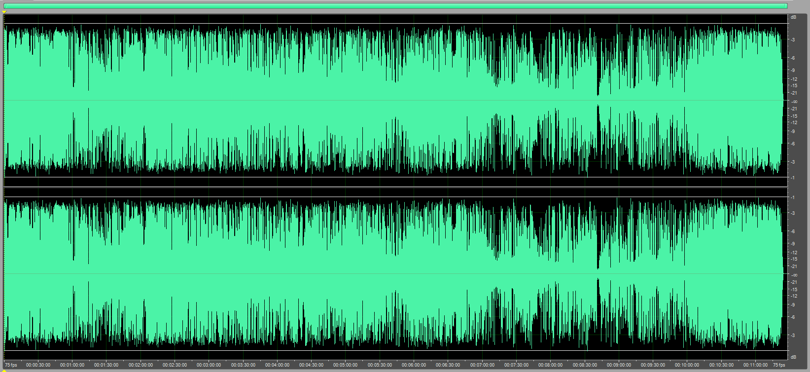

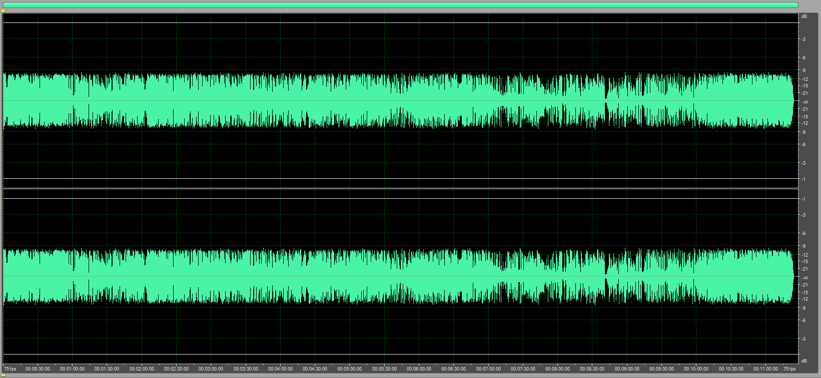

Because I would have normally encoded this straight out of XVID4PSP as an AC-3 file I went ahead and did the process again, doing just that (instead of outputting it as a PCM WAV audio file).
I normalized it to 90% and saved it as a 320kbps AC-3 audio file.
Below is a view of that file from Adobe Audition:
And now (below) is a view of the original PCM WAV file that I first extracted (no normalization)
As you can see the original, extracted without normalization, is a bit low in volume. So I decided to use my method which normalizes and extracts directly to AC-3 (since this is intended for a DVD Video).
