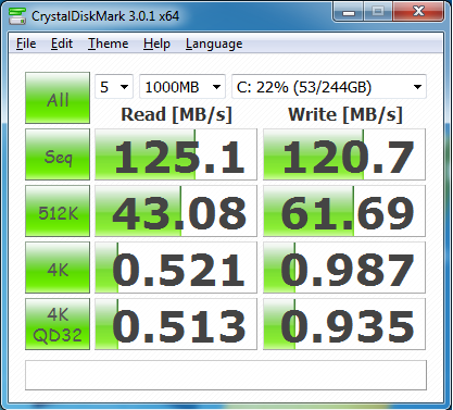

    I'd be inclined to run the CrystalDiskMark HDD benchmark on your hard drive before assuming it's the bottleneck.

  4. here it is:
    attached.

    Those figures are pretty much what I'd expect to see from a typical healthy drive. I don't know what's causing your problem, but it's definitely not your hard drive unless it's incredibly badly fragmented.
    You could try running MyDefrag on all partitions to see if it helps. It certainly won't do any harm and will give you something to try until other suggestions arrive.

    So you mean that the current HDD is good enough and nothing wrong with it?
    But the question still why the CPU is only using a few part of the cpu power?
    While the application is using all cpu cores and all cpu threads?

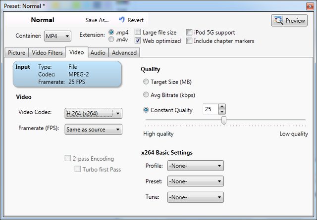

  7. As jman98 said, the hard drive speed is almost never a problem. Only when you work with uncompressed, or losslessly compressed video does the drive speed really become an issue.
    What codec are you encoding with? x264 (used by handbrake) is well multithreaded but most MPEG 2 and MPEG 4 encoders are not. I've never used ffmpeg's MPEG 2 and MPEG 4 encoders but I would guess they are not well multithreaded and won't be able to take full advantage of an 8 thread PC.

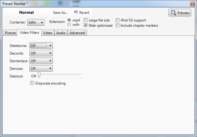

  8. There might be other processing bottlenecks. eg.. are you deinterlacing, resizing? any filters are potential bottlenecks
    The source file is .TS or .MPEG-2
    Both types are resulted from PCI sattalete capturing using DVB-S2 Tevii-420

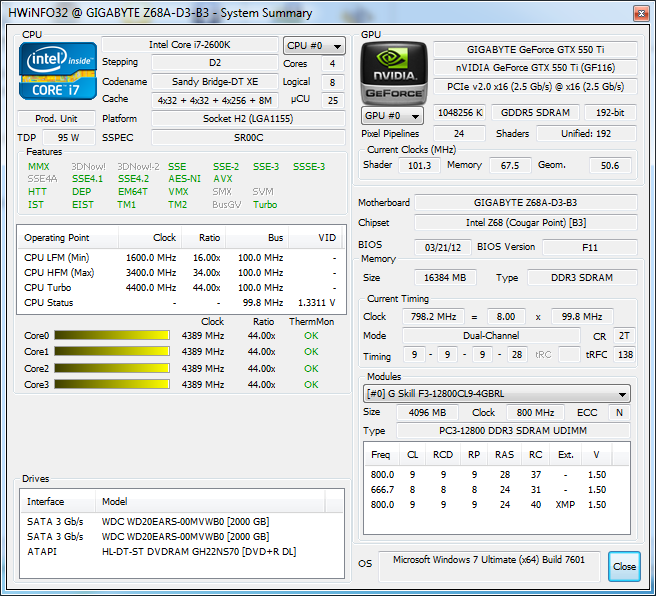

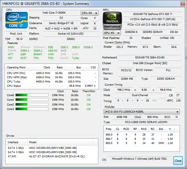

  14. Originally Posted by wulf109 View Post
    this is in idle
  15. Member wulf109's Avatar
    Jul 2002
    When you open the program there's a small box,check sensor only and click on run, ver 3.96. I'm running Vidcoder now and getting 99-100% utilization at 52fps converting a BR 1920x1080 to 1600x900. Running an I7-960 at 4.0ghz.
  16. here it is
  17. Member wulf109's Avatar

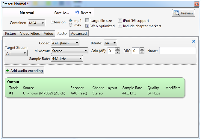

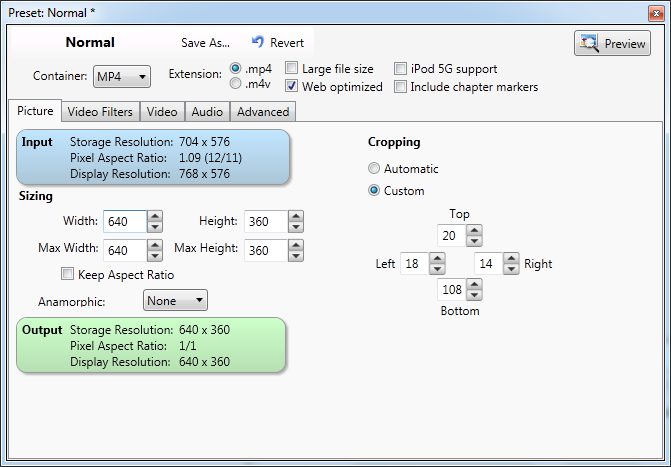

  24. Hello,
    Just to update you with my latest info and after trying many things I've found that VidCoder is really using all cores of the CPU.
    Also, what make it slow os fast will depend on exactly what kind of editing you will do like cropping and audio settings, ...etc.
    But For almost all tried attemps I've found that using the same audio sample rate is the best option, and when I try to make it 44100 I've found it jump to take more time.
    So Any one would like to use VidCoder (which is brilliant by the way) to decrease encoding time must not change the audio sample rate and even cropping or any other thing will not consume a lot of time.
