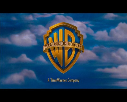

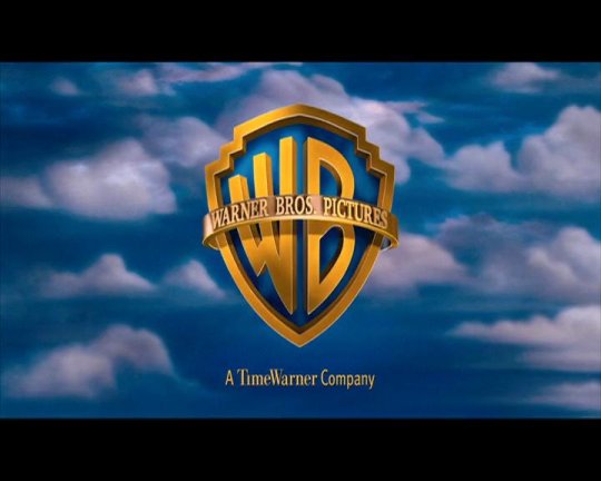

    Well seeing as I've wasted a bit more time that I shouldn't have today, I wasted a little more and looked at a my encodes again, also comparing them to the source. I navigated to the middle of the video, stopped them all on identical frames, maximized them on the TV and switched between them. And I've still got to say, neither were perfect, but neither was worse than the other. The scene was of people eating at a table with a dark background, and I could switch between the two encodes and really nitpick, even say well over here the CRF did a slightly better job while over there 2 pass did it better, but when it came to comparing them both to the source that kind of changed a bit..... and this is still real nitpicking stuff because it's comparing frames a couple of feet from a 51" plasma..... once I added the source video into the mix while switching between them "better" was too subjective and "accuracy" took it's place and there was just no winner.
    In the end I focused on one particular person's face (almost in the background) because that's where I could see the biggest compression differences between encodes, and while initially I assumed the 2 pass encode had done the better job there, once I compared them to the source it wasn't so simple.. The 2 pass encode burred his mouth a little more compared to the source, but when I looked at the shadow on the side of his face I thought maybe the 2 pass encode replicated the edges of it slightly more accurately, yet the CRF encode retained a tad more detail. I tried the same comparisons using a reflection off the table and even after switching between them numerous times I couldn't decide which encode got it closer to the source because it just came down to slight differences.
    Finally I sat back while switching between them and trying to take the picture in as a whole to see if compared to the source one looked more accurate over-all, and I'll admit just by trying to get an over-all impression that way I'd probably have given the CRF encode a very marginal edge, but once again this is frame by frame nitpicking and the next frame 2 pass might be the winner. Normal viewing distance, normal playback speed, they're effectively the same.
    It did occur to me right near the end that maybe if I switched MPC-HC to a different resizer and went through the process again.....
    Anyway I'm pretty convinced. Yes when comparing my CRF 18 and 2 pass encodes there are compression differences to be seen frame by frame, but the upshot of it is neither equates to a quality difference as such and at normal playback speed they're effectively identical. I'll try some more testing in a day or two.

    Original DVD video:
    MediaCoder encode using the Slipster preset without any additional adjustments:
Name:	Slipster Preset.jpg
  23. Well I ran a couple of short test encodes, your preset, color/level conversion disabled, two with and two without deblocking, CRF15. I picked the two scenes I'd looked at earlier when testing out the effect of MeGUI's mpeg2 deblocking.
    The first was very static, close up of the actors face, light background blocking. The second a fairly dark scene, blocking and noise for days. In both cases applying deblocking reduced the file size, so no doubt it was doing something, but in both cases while it didn't seem to have any visual effect on detail (just using my CRT monitor to compare them) it seemed not to do much in the way of deblocking either.
    Tentative conclusion..... MediaCoder's deblocking doesn't appear to be doing anything special. It seems it just uses a less argessive deblocking threshhold than MeGUI does by default, hence retaining more detail but reducing the blocking by a far lesser degree.
    No different to any other deblocking I've tried, I'd imagine. The more you crank it up, the better it deblocks and the more detail you lose. In the case of MediaCoder and it's deblocking, assuming what I've seen is typical, I'd agree it has virtually no effect on detail. Just don't expect to see much actual deblocking happening either. I could see some minor blurring of the worst of the blocking when comparing identical frames. Nothing more.
