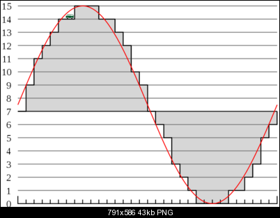

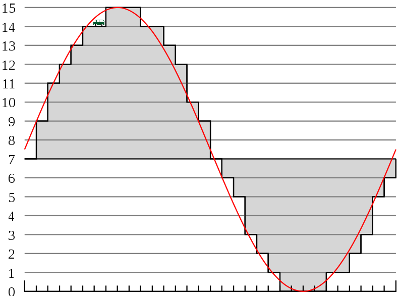

    Without some example (that is not qualified by having bad mastering/engineering errors - of which there are plenty of occurrences both analog & digital), you really shouldn't be talking about "holes big enough to drive a truck through". Talk about exaggeration.
    hehe yes they would have to be microbot trucks. but the analogy holds. digital music is stair-stepped square pattern that approximates the analog original. just not closely enough for some. i sold high end audio gear for years and have worked in an audio recording studio. it's just my preference to hold out hope for a "closer" approximation someday than 44.1 16 bit.
    here's my truck driving through a digital audio hole. could just as likely be an strat violin that lost it's unique timbre in there.

  8. Originally Posted by aedipuss View Post
    You forget (intentionally or not) RECONSTRUCTION FILTER which is MANDATORY from sampling point of view - remember that correct analog to digital then digital to analog system imply at the input correct ANTIALIASING filter and correct RECONSTRUCTION filter at the output.
    And there is no big trucks and big holes - this is pseudoscientific blabling .
    Yes there are discrete values in discrete times but until whole system is correctly designed You can reconstruct ANY complex (magnitude and phase) signal with accuracy of single time/level quantization step.
    With perfect antialiasing and reconstruction filters You need only two samples with less than perfect You need more than 2 samples.
