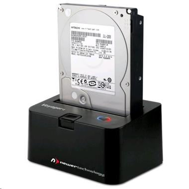

    Me.... I've got around 12 "external" drives these days of various sizes and ages. Not one of them in an enclosure. I used docks. Something like this:
    There's a dock permanently attached to my Bluray player, a dual drive dock connected to each PC, and a dock connected to the USB media player in a TV in one of the bedrooms. I just swap the hard drives around. If I was to buy a new drive for external storage it'd be a WD Green drive as they're nice and quiet and have proven to be very reliable.
