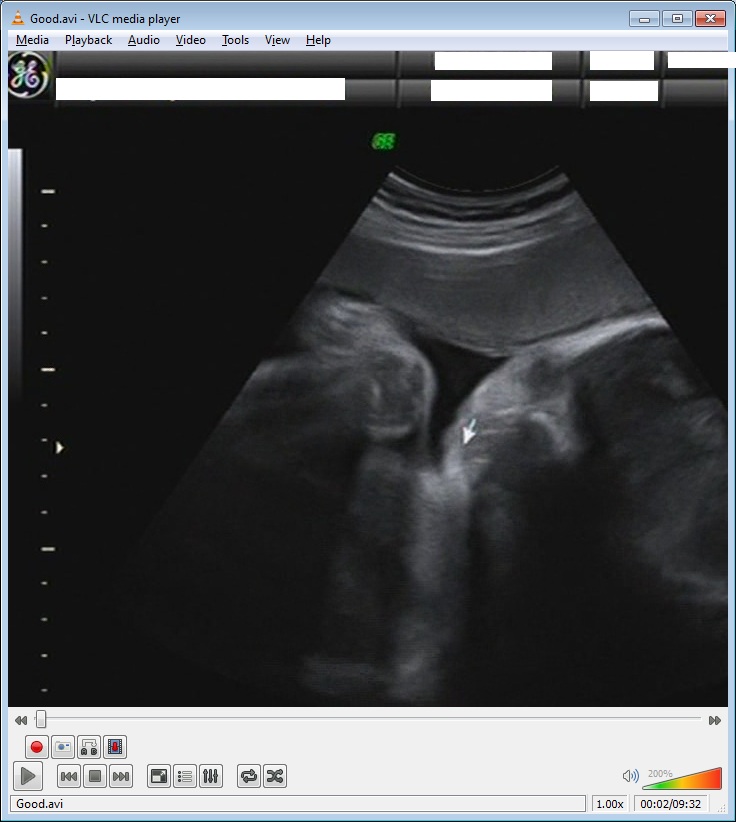

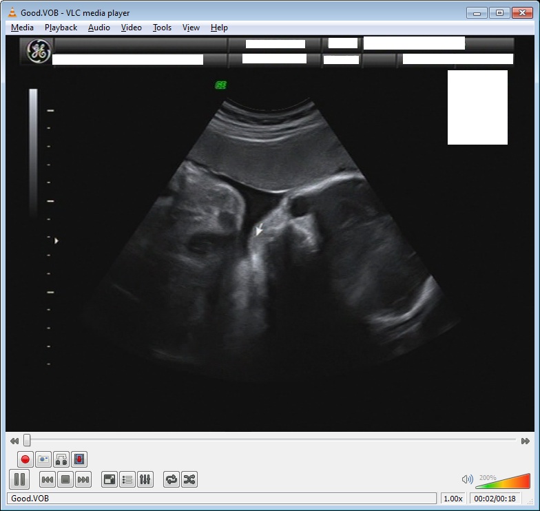

    I'm using AutoGK to convert some DVD video into AVI (Xvid), however I have a problem with it. For some reason when I do it the conversion only seems to use part of the original, and cuts off some to the right and bottom of the video. I've tried changing the width settings on the AutoGK setup, but it's not making any difference. I haven't run into this problem before - anyone have any ideas? Screenshots should help explain what the issue is (note the white boxes should be there, as I've just edited them out from the screenshots).
