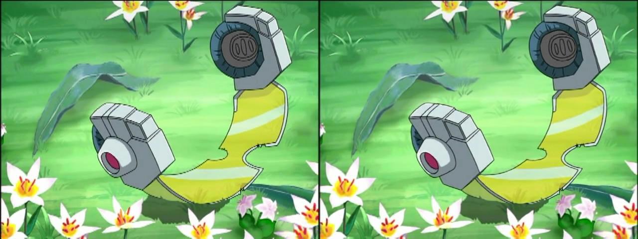

    Does anyone know a filter specifically for this? I have encodes for a cartoon that I want to fix. They are otherwise good quality but suffer from jaggies in certain scenes. I was wondering if there was a way to get rid of them. I don't have the original source, so basically this is what I have to work with.
    Here is an example: http://www.freeimagehosting.net/newuploads/uzhgf.jpg
    Any suggestions?

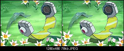

  2. They are very hard to ameliorate. It's best not to get them in the first place. IVTC film sources. Use a better deinterlacer (if you really need to deinterlace). If your source has already been deinterlaced like that try to find a better source.
    As a last resort try nnedi3_rpow2() in AviSynth. Before and after:
    ImageSource("uzhgf.jpg")
    SeparateFields()
    SelectOdd() # keep the better one
    nnedi3_rpow2(2, cshift="BicubicResize", fwidth=640, fheight=480)
    You'll still have some buzzing edges when in motion.
