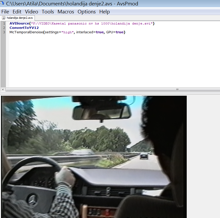

  1. I used mctemporaldenoise ( almost all settings () high, low interlace= true gpu =true and so on ) and get some kind of posterization and flickering.
    Source lagarith 720x576 pal 25 interlaced

    commenting does ok so it is the filter ( i guess ) but i didn't see anyone before complaining about the same results that way I asked general question I was doing allot of installing and deleting recently so maybe i did screw something up.
    Why will mctd do such thing any thoughts ?
    It starts ok ( in the avspm preview everything looks ok ) no artifacts then in the middle of the rendered clip it starts this posterization and it continues till the end of the clip. I just uploaded the part when it starts doing it.

  11. Somewhere along the line one of the filters (probably in the deinterlacing) is generating an edge/motion map. That map isn't being handled properly and is becoming part of the picture rather than being used as a mask. In all likelihood this is caused by incompatible filter versions. But try deinterlacing before MCTD.

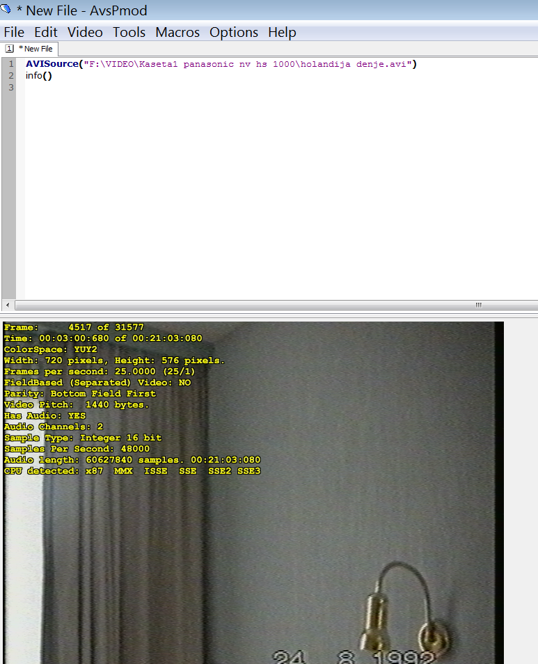

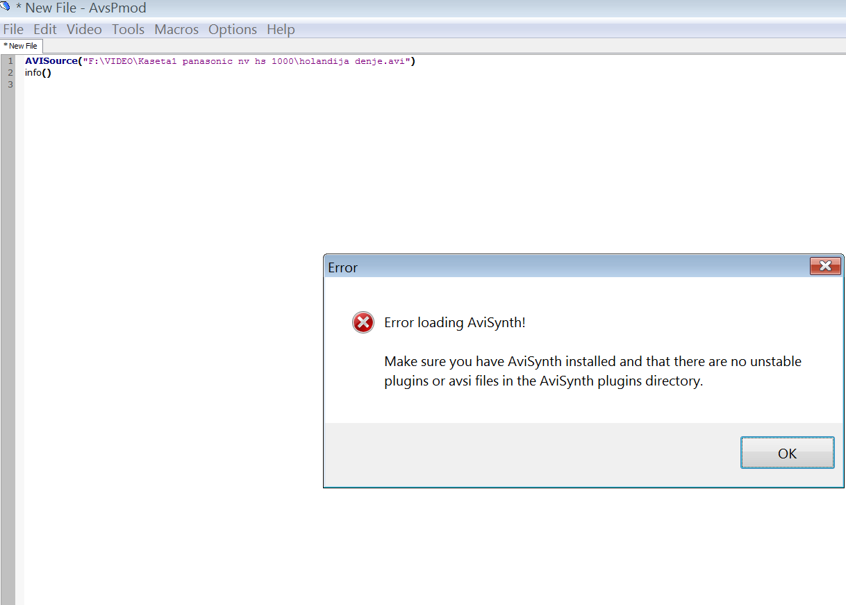

  12. I uninstalled avisynth and avspmod and installed it again with clean plugin folder. I started to put filters and auto load scripts and now i have problem to get it to work. As soon as i put lfsmod.avsi or MCtemporaldenoise.avsi i get error ( ether of them separately meaning one without the other or both together ) nothing happens before that
    solved it now just to render to see if i get the same psycho effect
