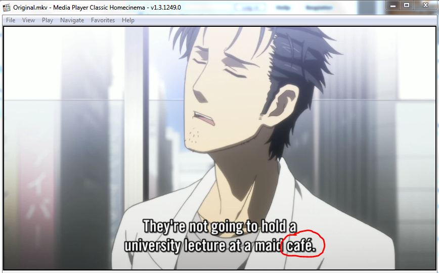

    I am currently re-encoding some files with hardsubs, since I need maximum compatibility for my DivX player. My original files is a MKV, and I am in the process of converting it into an AVI. If anybody wants some context in how I re-encode, I use a AVISynth Script with VirtualDubMod.
    At the same time, I also use VirtualDubMod to hardsub the subtitles. I have installed VobSub, and use its TextSub filter that it installed in VirtualDubMod to do the job.
    My problem is that certain fonts do not display or covert properly after I finish re-encoding.

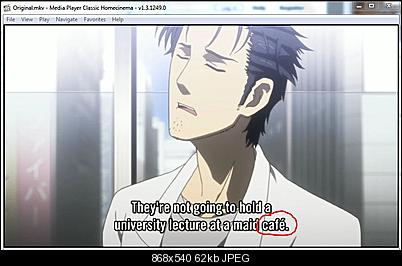

    For example, this is a picture of the original file:
    The word circled in red is of interest here.

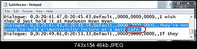

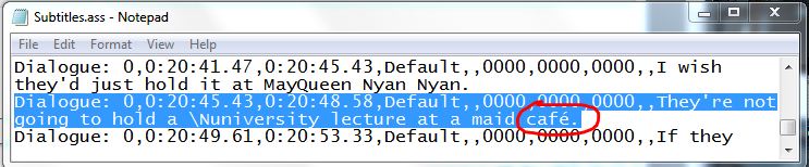

    Now here is a picture of the subtitle file:
    The word circled in red seems to render fine in both the video version and the subtitle file on my computer.

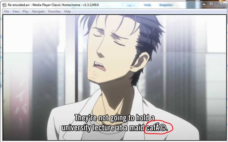

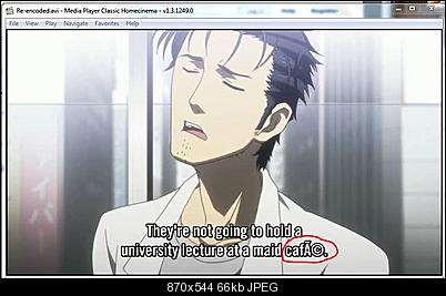

    But after I convert the file through VirtualDubMod, and add the subtitles through VobSub's TextSub filter (in VDM), I get this:
    Notice that the converted result converts the text in an ill manner.
    Can anybody help me here and tell me what has happened? I suspect the problem is either in VirtualDubMod or VobSub, but don't know where to start. Any tips would be nice.

    Make sure the font you're using to hardsub can actually handle that character. If the MKV you're using has fonts included for the subtitles, you might try installing them. (I can't remember whether or not you can get away with having them in the current directory as the videos when you're hardsubbing.)
    Also, if you haven't already tried it, you might update VSFilter (copying it to VirtualDub's plugins) to the latest version.

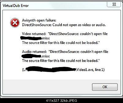

    I try opening the AVISynth script and get this error:
    What frustrates me is that this I used this exact same script to make a converted file I showed you guys a couple of hours ago. What happened?

    Now... can anybody guide me with my DirectShowSource error?

    Both files are in the same folder. Judging by the wording of the error box, it seems AVISynth can find the file, but DirectShowSource doesn't seem to know how to react. I am not too sure as to what to do to fix DirectShowSource.
  10. Originally Posted by adalect View Post
    Don't use it. Use FFMPEGSource instead:
    http://code.google.com/p/ffmpegsource/
    http://ffmpegsource.googlecode.com/svn/trunk/doc/ffms2-avisynth.html
  11. DECEASED
    Jun 2009
    Heaven
    ^ Well, the fact is, Avisynth not always builds (or attempts to build) a DirectShow graph in the same way as MPC-HC for example (not to mention Graphstudio and the infamous Windows Media Player). As a last resort, you can always (try to) build a functional graph manually in Graphstudio, save it, and apply DirectShow Source() on it. Besides, thanks to the 'convertfps' option, you can choose a framerate value more convenient than "23.810fps"
    Even though FFMpegSource is very-good, I simply don't like it very much Especially because in certain cases it has to use the annoying Haali Media Splitter. I prefer both LAV Splitter and AV Splitter to HMS, which is still "most useful" only to the «animé "releasers"», apparently.
    Sep 2008
    Planet Snack!
    I did another batch of Googling, and many people mentioned that codecs may be a problem. I found that DirectShowSource failed to work with MKV files (but not AVI files), so I uninstalled and reinstalled the Haali Media Splitter package I had. Now it works! Thanks for the help so far guys.
