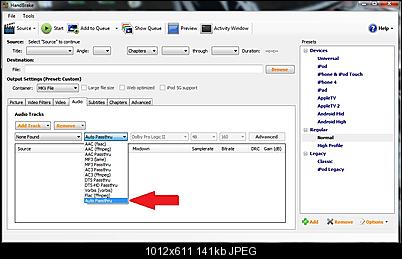

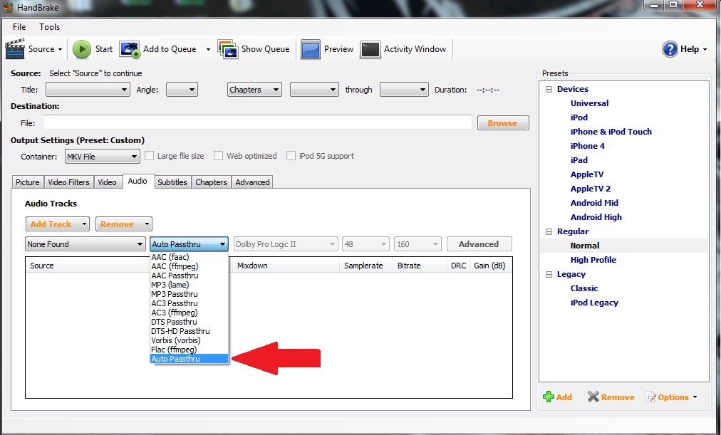

  9. Banned
    Jun 2004
    ®Inside My Avatar™© U.S.
    I have used it a few times to shrink down movies to 8gb mkv's while retaining the original audio track.
    It blanks out the other audio settings as it is just passing the original audio through.
