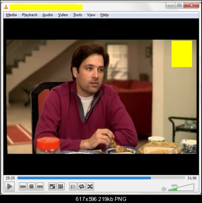

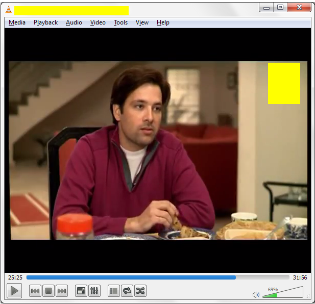

    The video is a YouTube (480p flv).
    Input Video has
    1. Aspect ratio of 5:4
    2. Resolution of 600x480 (Black Bars = 30 pixels at the top and 30 pixels at the bottom) as shown in Picture and Info below.
    Which tool shall I use and what settings will be appropriate to do the following
    1. Remove Black Bars
    2. Change aspect ration to 16:9
    3. Encode Video as MP4 .

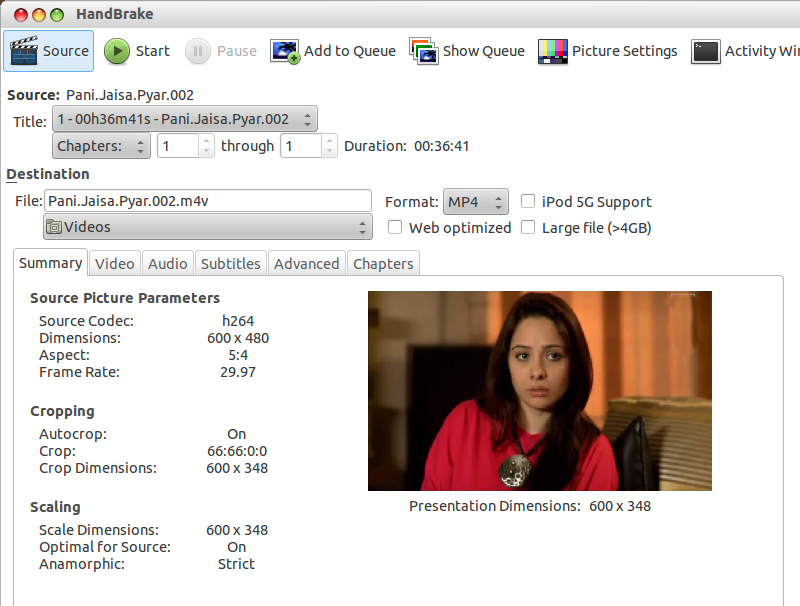

    The video I am trying to convert is from Youtube and encoded as FLV 480p. I think the black bars were there in the uploaded video because at some point in video there is text at the bottom.
    First I tried SUPER 2012 build 52 to convert the video, little did I know that it has bundled viruses. I spent more than 2 hours remove the junk from this software.
    Today I tried Handbrake, It detected the source as 600x480 (5:4). It automatically cropped the black area at the top and bottom with resulting video as 600x348 and strict anamorphic i.e 16:9. See the image below

    Although Handbrake allows me to crop and re-mux, I haven't found option to do it without re-encoding audio and video streams.

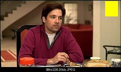

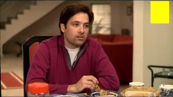

  7. 5:4 is the D1 frame size ratio for PAL video. If you look closely I think you'll find that every 6th frame is a duplicate because a 25 fps PAL source was converted to 29.97 fps by duplicating every 5th frame.
    Assuming it was a 16:9 video letterboxed in a 4:3 DAR PAL frame, I would crop away 64 lines at the top and bottom, 8 columns at the left and right, then resize the height to leave 584x328. That will probably be close to the original aspect ratio:
    I'd also remove the duplicate frames.
