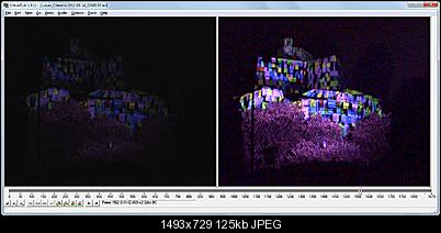

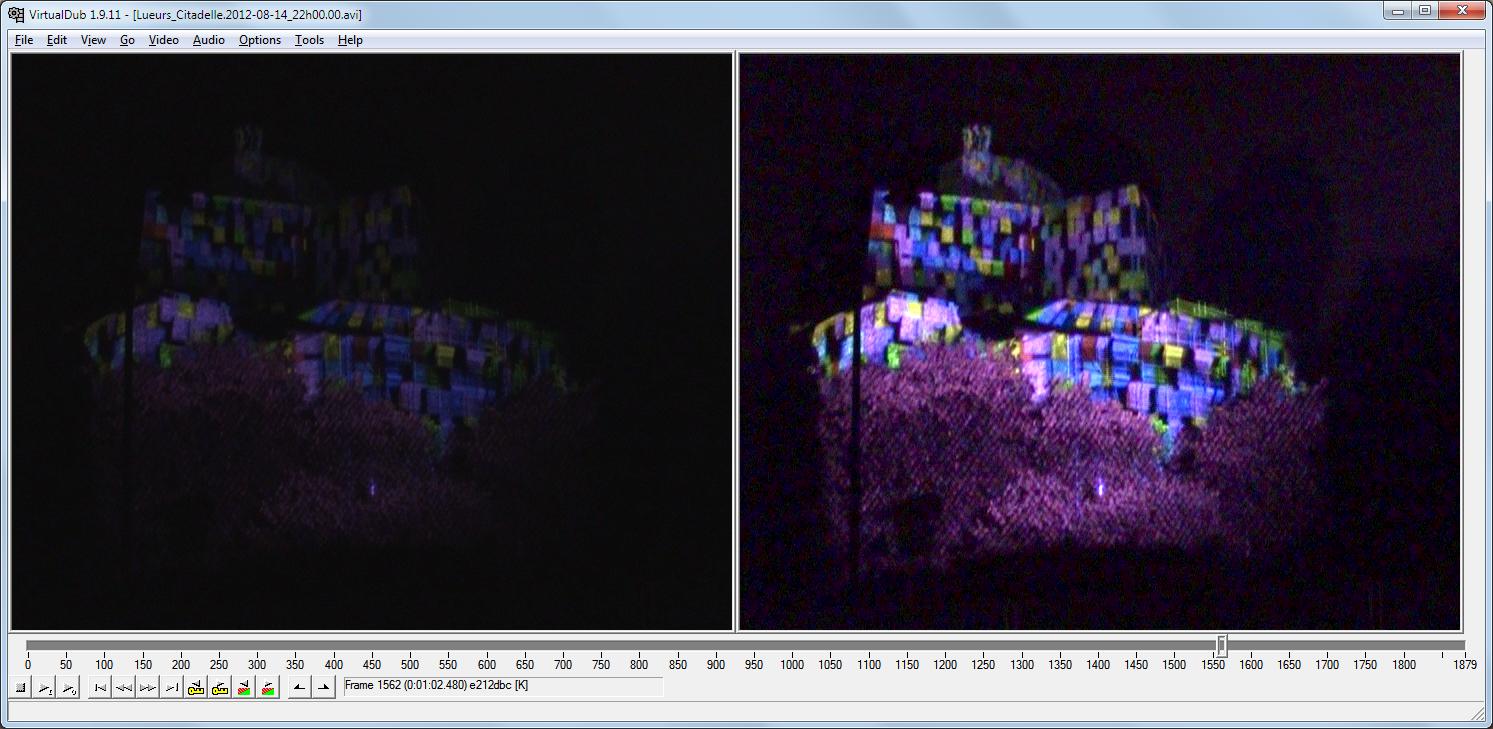

  3. Try VirtualDub. It has lots of filters for changing brightness, contrast, saturation, etc.

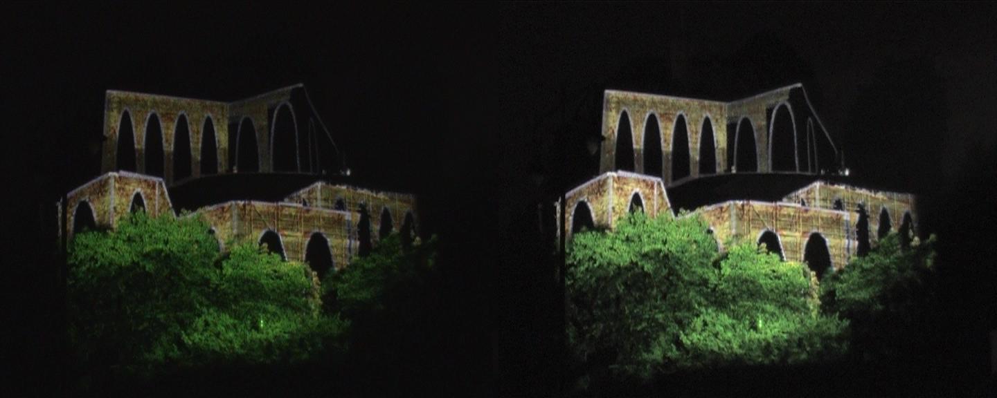

    The video is terrifically underexposed -- which is another way of saying that what you have in the darkest areas is pure noise, not detail. Making the darks "brighter" will only amplify noise and severe mottling. Dark detail was crushed in the camera. Opening the file in VirtualDub improperly might have crushed dark detail more. But....c'est la vie.
    A quick try with ColorYUV, TemporalDegrain, QTGMC, GradFunc2DBmod, NeatVideo, gradation curves, ColorMill. Didn't have time to experiment with the dark mottling. But this would be a good study for trying to see what Dither() and its version of Dfftest can do.
    night-TD_QGF_vd2.mpg (PAL, 66MB)
    [Attachment 13520 - Click to enlarge]

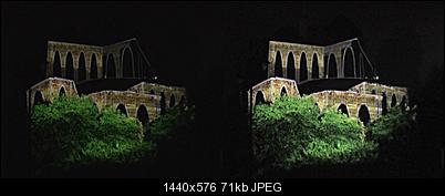

  17. Start around here:
    AviSource("sample_citadelle_2.avi")
    ColorYUV(off_y=-34, gamma_y=150, gain_y=150, cont_u=100, cont_v=100)
    TTempSmooth(maxr=7, lthresh=20, cthresh=30, strength=5)
    Adjust to your liking.
