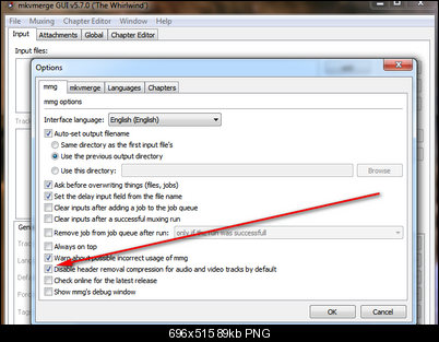

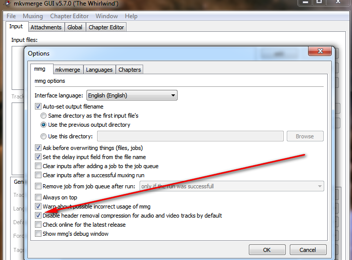

  8. did you disable header removal compression in the mkvmerge options? It can cause playback issues with many standalone units

  10. Originally Posted by carlmart View Post
    Yes, I did remove the header two times: first when I replaced the AC3 instead of the AAC, and it didn't play; second when I simply removed the header stripping, leaving the AAC, and it didn't play either.
    I am quite used now to removing the header, even if it comes only in about 10% of what I download.
    Are we referring to the same thing ? I'm not talking about removing the header; I'm talking about disabling header removal compression.
  11. aBigMeanie aedipuss's Avatar
    Oct 2005
    666th portal
    May 2004
    Brazil
    I think we are talking about the same thing, though in my version (4.9.1) it's done a bit differently.
    Extra options > compression > none.
    That is done for video and audio tracks.
    As I said it's how I remove header stripping.
