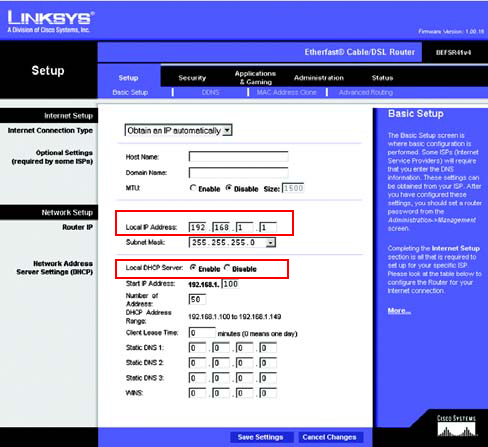

    Jagabo covered this. but maybe some more detail:
    Every router has a different setup, but they all do the same thing in the end.
    I looked at the User Guide at http://homesupport.cisco.com/en-us/support/routers/BEFSR41
    See Chapter 5 Configuring the router
    First, to config the Linksys, connect your PC to it instead of your normal router temporarily.
    Open its config page in the browser, should be http://192.168.1.1
    default login and password is "admin".
    A few things you need to change: See attached screenshot.
    Each router needs a different IP (on the local network, not the Internet)
    Many routers use 192.168.1.1, so if your other one is that, you need to change the Linksys
    "Network Setup/Local IP address" setting. 192.168.1.254 say should be okay.
    And disable "Local DHCP server"
    save the settings.
    (Note: now its config should be at http://192.168.1.254 )
    Now the router should basically be a switch.
    You should be able to daisy chain it to your original router with an ethernet cable between the LAN ports.
    If it doesn't work you may need to get a short "crossover" ethernet cable. These are maybe $1.
    (See http://answers.yahoo.com/question/index?qid=20110607235359AARrCz8 and
    http://www.ezlan.net/router_AP.html )
    However, at the end of this, you go from 4 ports on the original router to 8-2 = 6. So if you need more, you might indeed get a dedicated switch with 6 or 8 extra ports.

    Thanks guys! It worked. Not needing to be online was the clarification I needed. However, still firefox kept saying there is no internet connection when I tried to get to 192.168.1.1. I held the reset button for awhile, and then it worked, I got to the admin page.
    I only did two things. I changed the LAN IP and I disabled the DHCP. I then used the UPLINK port from the Linksys and plugged the other end of the ethernet to one of the ports on the fios router. I plugged the nearest PC into port #2 of the linksys to see if I get a connection, and I did.
