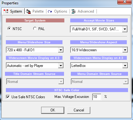

    Project properties: NTSC, Full D1, Widescreen, letterbox, letterbox.

    I think the AR issue is because you have over-ridden the settings by changing the VTS properties. These should be left as 'Same as Project Properties'.

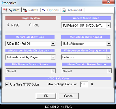

    make sure your dvd player is setup properly to display widescreen. i've made hundreds of dvds with dvdlab and never had one not display properly. make sure your project properties are set like this.
