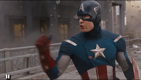

  4. Originally Posted by zanaitoryoushi View Post
    can you evaluate if this is good enough?
    No, no one can evaluate a script without seeing the video to which it is being applied.

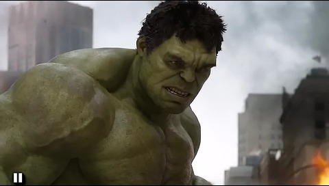

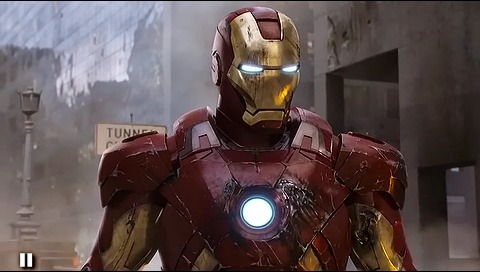

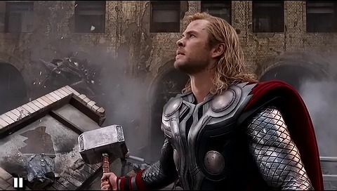

    LoadPlugin("C:\Documents and Settings\Administrator\Desktop\Tools\AviSynth plugins\SmoothLevels\ICL\avs-2.6.x\x86\SmoothAdjust.dll")
    video=Smoothlevels(video,chroma=100, preset="tv2pc")
    LoadPlugin("C:\Documents and Settings\Administrator\Desktop\Tools\AviSynth plugins\dfttest\dfttest.dll")
    video=dfttest(video, tbsize=2,sigma=1.2,tmode=1)
    LoadPlugin("C:\Documents and Settings\Administrator\Desktop\Tools\AviSynth plugins\Sharpeners\UnFilter.dll\Unfilter.dll")
    video=Unfilter(video, 70, 70)
    LoadPlugin("C:\Documents and Settings\Administrator\Desktop\Tools\AviSynth plugins\Spatio-Temporal Filter\deen.dll")
    video=Deen(video, mode="a3d", rad=3, thrY=7, thrUV=9, min=0.3)
    #Colors
    video=Tweak(video,hue=0,sat=1,bright=5,cont=1)
    can you evaluate if this is good enough? please point out any flaws that you see, i appreciate criticism, i'm fairly new with this..
    Can't advise in detail. Screen captures don't tell how the original video looks. Colors look pretty correct, but your script might be easier to read and maintain if more conventionally arranged:
    Smoothlevels(chroma=100, preset="tv2pc")
    Unfilter(70, 70)
    dfttest(tbsize=2,sigma=1.2,tmode=1)
    Deen(mode="a3d", rad=3, thrY=7, thrUV=9, min=0.3)
    #Colors
    Tweak(hue=0,sat=1,bright=5,cont=1)
    However, this statement
    crushes the darkest colors.
    [Attachment 13491 - Click to enlarge]
    Note how the darks are smashed against the left-hand side of the histogram. You won't see any detail there. Looks OK on a PC, might not look so great to an encoder or TV. Depends on whether your intent is PC display or TV display. In this case, however, we're looking at a jpg capture, not at the original video frame.
